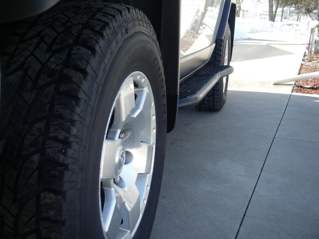

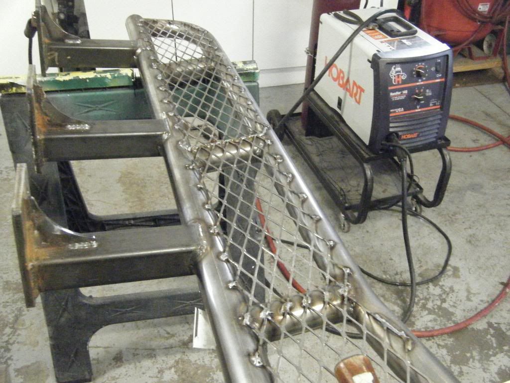

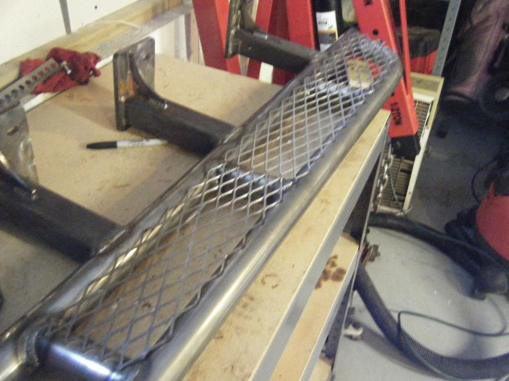

quick pics of what I did. I used expanded steel for the fillers
I welded all the steel pieces to the tubing.

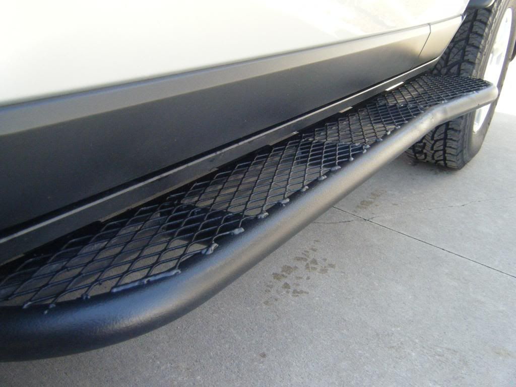

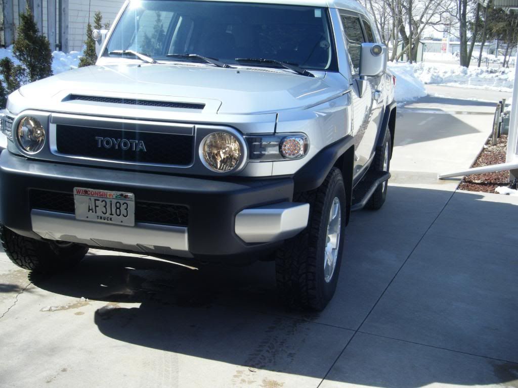

Two coats of self etching primer and 5 cans of Dupli-color truck bed coating and they were done. Let them sit for a few days and installed today.

I will, gotta wait for our foot of snow to melt. I ran with a 16 gauge steel and there is no flex to it at all when you step on it,even on the back one

i laid the steel right over the sliders and made marks with a sharpie, then cut it off with a cut off wheel. Then I put it back down and checked the sizing and just ground it down with a bench grinder. Luckily the other side was identical so I just had to trace the first pieces over it and do the same
