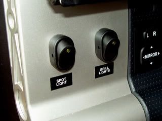

Carling sealed rocker switches, part #432-1088-ND Switch Rocker SPST 12V 20AMP Sealed
2 lights, one lights with dash lights, 1 lights when circuit activates
$11.20 each, $9.00 each for 10 or more
Digi-Key Corp. 1-800-344-4539 digikey.com
The stock holes in the center console are stepped, smaller as you go in. The sides of the switch openings require trimming from behind with a utility knif, about a minute, very easy. The new switches are held in by the top and bottom

Rocker switches for round hole mounting. SPST. Can be mounted in either in flat panel areas, or center-mounted on the OEM switch blanks. Illuminates (red, green or amber) when activated.
Boat supply stores, Radio Shack, etc. @ $3.50 each.
