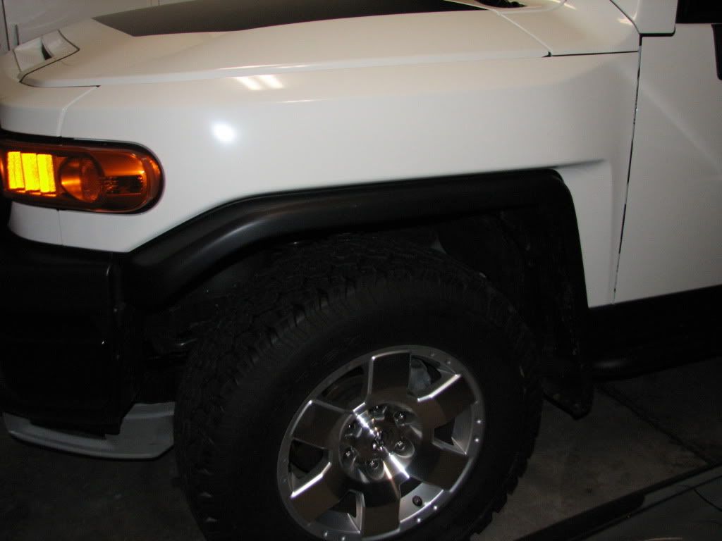

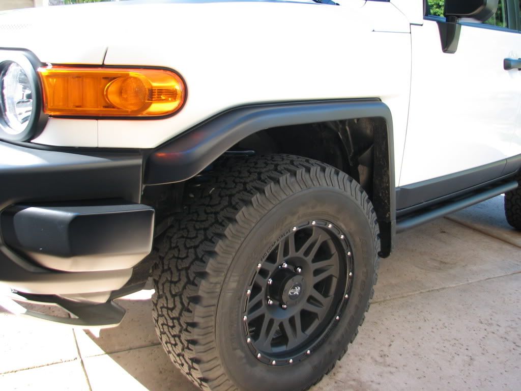

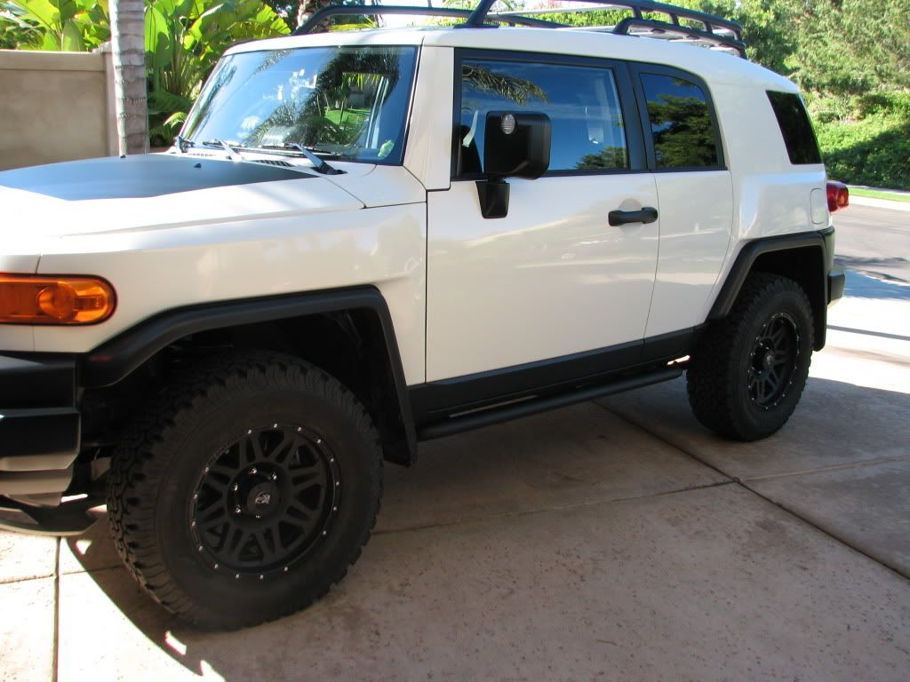

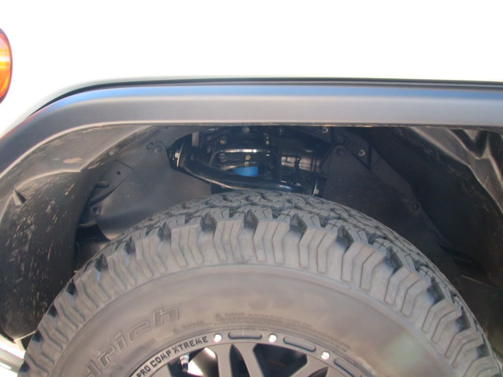

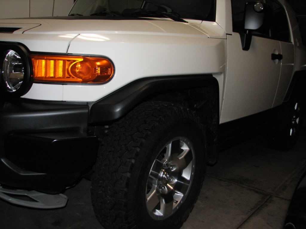

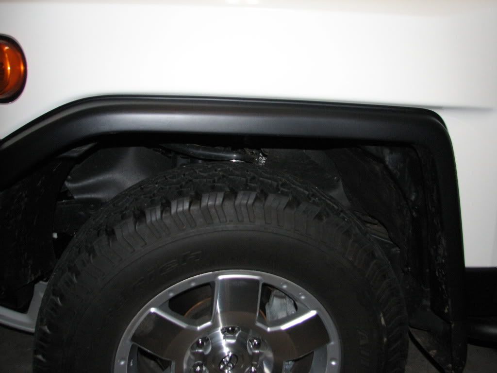

These are Toytec front spacers that are 1/2" thick(P/N 25912), it's says on Toytec's website that they give 3/4" lift but they gave me EXCACTLY 1" of front lift. The stock FJ is 2" lower in the front than the rear so now I am only 1" lower, which is perfect.
MEASUREMENTS:
FL:34.75 to 35.75
FR:35 to 36
RL:36.5
RR:36.75
Here are some pics:
BEFORE
AFTER
