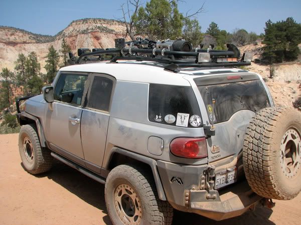

Shot below of my rig at N. Rim Grand Canyon - you can see how far they clear the wheel wells.
One thing to keep in mind with a wide beadlock ring is that they are HORRIBLE in mud since the mud cakes in behind that beadlock ring. We don't drive in mud very often in SoCal so it's not much of an issue - Michigan may be another thing and you might want to consider a narrow beadlock ring instead.
