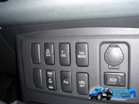

The dealer has sent me a picture of the dashboard:
Vehicle Car Automotive wheel system Center console Auto part
It seems the RR DIFF LOCK switch is there... what do you think? Yet I fail to find this feature in the "Toyota Invoice" document he has sent to me.

Well it's definitely there. Could the Rear Diff Lock be part of a package that is mentioned on the papers you have?

I am still confused but anyway the presence of the button should make it clear the rear locking differential should be there.
Alessio
