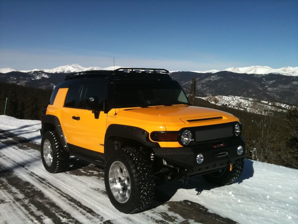

I'll just get down to it... but let me first say almost every one of my ideas was generated using this forum. I simply tweaked them as I saw fit for my "Short Bus." I sincerely think this site is one of the best tools in my recovery bag -- seriously. So props to everyone else -- and if you see an add-on that looks familiar, thank you.
Short Bus is a 2007 with 7,000 miles on it. Needless to say she's spent a LOT of time in the shop getting wrenched on by myself and a few places that I found to be on par with my OCDness.
Don't let the Nebraska plate fool you -- she's spent most of her life in Colorado and is purpose built for many moons up in Alaska when I move there in the next few years. (oh... wait... there are moons in AK right?!)
My objective is and will continue to be:
OEM look and cleanliness while being damn near unstoppable.

So this is where Short Bus got it's name.
Obviously that wasn't going to fly, so I started with the exterior paint. I'm a paint/body man in a past life so that's where I felt most comfortable personalizing my FJ.
Day one I debadged it entirely, had Mountain States Toyota of Denver, CO remove the OEM roof rack (bad things happened, see SC install thread about 3 replies down) and install the TRD big brake kit (had them include it with the sale... otherwise not worth it IMO for the 0.1" increase in rotor diameter) and TRD exhaust. When I got it home I applied a 48" clear bra to the hood and completely wrapped the front fenders. This has proven to be worth every penny. I used to do this as a side business, so I bought in bulk and applied it myself.
Then I sprayed a two stage PPG Jet Black on the roof and A pillar. This was NOT an easy job. For one, the most rear side glass is glued into place, so to remove it without breakage is impossible. Also, thinking I liked the bald FJ look, I had to remove the plugs that cover where the roof rack feet insert. Which, is easy -- but to get a clean job I had to move the entire plastic rail system (the plastic in between the feet that serves no real purpose other than to redirect water out of the channel back onto the metal roof) to avoid "clear bridging" between the rails and the metal.
Also what presented a problem was the lateral piece that is directly above the windshield. Talk about a PITA. I ended up removing the entire assembly (there is a metal plate behind the plastic cap) and replacing it to the tune of $680 or so.
The "black out" of the exterior bits was fairly straight forward and fun. I went a single stage PPG flat black. I added a little flare to the brake lights and hideous orange turn signals.
The billet grille insert was a straight forward install.
Interior was blacked out to match using some SEM plastic adhesive promoter and some good' ol rattle can textured black. The finish is quite nice... hmm, I guess I'll have to find some after photos...
Probably one of my favorite, yet challenging parts to this puzzle was the All Pro front bumper. I honestly can't stand the two holes they put in their bumpers. I looked for-ev-er for one of their old, flat faced bumpers but to no avail. I decided that I'd machine two additional holes outboard of the IMO useless winch access holes. I custom cut them to the size of some KC HiLite slim fog lights, welded a couple of tabs on the back side and -- whala -- instant USABLE holes.
The problem that came about from this was filling the old holes. Although I had the metal from the holes I just cut -- and had them within .002" that I filled with a quick weld bead and smoothed down -- there still was a lip that you could catch your fingernail on. Knowing that attempting to fill it with body putty and then paint would ultimately lead to cracking, I looked to my buddies at LineX.
OMG did I Line-X the bejesus out of this thing. Bushwacker fender flares, rock sliders, front bumper, rear bumper, skid plates .... basically everything plastic that could get schwacked with flying rocks or the metal underneath is now completely protected. It actually looks pretty sweet too.

So 20" wheels probably aren't necessary, but damnit I wanted them.. :)
MB Motoring Razors are what these wheels are -- but I have to say that THIS set of 5 is one-off. Reason being is that MB Motoring doesn't make a 20x10 that is hubbed for the FJ. They only make a 20x9. Weak sauce.
You'll notice in one of the first pictures that the hub hole is small. Too small. Way too small actually. With my help from friends at Lincoln Machine, Lincoln NE (read: paying them out the wazoo) they machined the hub bore to the appropriate diameter and even added the hub-centric angle so these ride as stock wheels would -- completely resting the weight on the hub, vice on the hub bolts.
I am very, very happy with how they turned out at Lincoln Machine still has the specs if you're interested.
I also am mostly pleased with the 33x12.50x20 Toyo Open Country M/Ts. I mostly have used them on icy/snow covered CO mountain roads and they have performed every time.
My only regret (and most likely my next fix) is to go up to 35s. Unfortunately, Short Bus barely fits in the garage as it is. So... yes, new garage time. :)

The part that I got the greasiest / bloodiest / most frustrated with was the installation of the Total Chaos "Optimum Travel" kit, Icon remote reservoir front long travel coil overs, Icon UCAs, Icon rear 2.5" piggybacks, Icon rear lift springs, Light Racing front/rear jounce shocks, Icon billet trailing arms, Icon billet upper links, Icon adjustable track bar.
It is also the part of the build that has absolutely morphed the FJ into why people often ask ... "is that a concept vehicle?!" and many, many nights of beer drinking and yelling at bolts with my buddy Garson.
Total Chaos makes some very, very nice stuff. They also were cool enough to have their powder coat shop coat my lower control arms black vs their customary gray. Their directions were straight forward and the games began:
I think chopping my axles in half was probably the most disconcerting part of the operation. I didn't have a diamond bit chop saw available at the time, so I took the grinder to them. Worked just fine.
The ONLY negative I will say about the TC kit is that the extended axles have already rusted. The powder coating on them is weak. It went from nice and flat black to what is now a crappy brown color. Unimpressed. (Pic to follow once it's out of the shop for axle build)
Icon... well, Icon has impressed the hell out of me. My rig rides SO much better than stock it isn't even comparable. And, yes, I got a free t-shirt with my order. :) LOL
The FJ is currently (May, 2010) in the shop at Crawlertech 4x4 Denver, CO having a Currie RockJock III rear Dana 60 hi spline rear, extended axle (custom cut to match the front's extra 4" from the TC long travel). It also is getting ARB front and rear air lockers and 4.88 gears.
This is what will finish the rig to Alaska-ready and as close to "unstoppable" as my wallet and foresight will afford.
