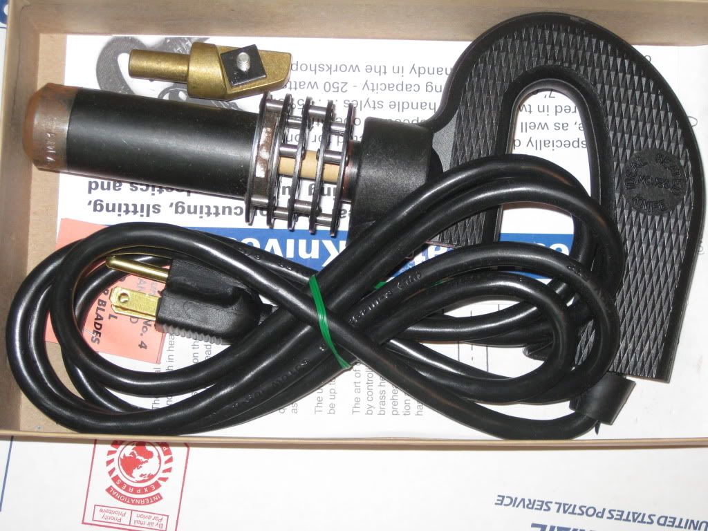

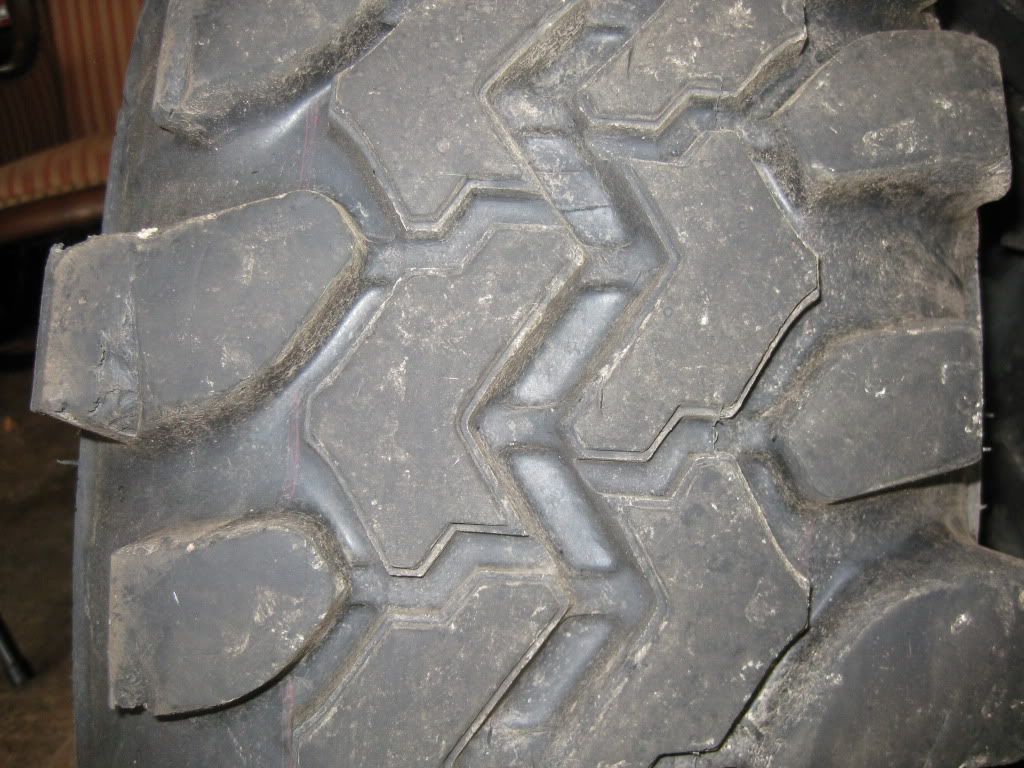

I have been running a set of 34/10,50-16 SSLTB's for some time they are great tires in mud but lack some in the rocks here is my grooving pattern.
My tool.
Before and after pics!:bigthumb:

What kind of tool is that?

The tool is a stock car standard around here about $70 off ebay.A buddy of mine used this pattern on his LTB's and his sons TSL's with great results.The sipes are about 1/4"by1/4" deep you can turn the ends on the tool over and make .030 sipes also.
As you can see I spin the LTB's in the rocks easily tearing out large chunks I had the same results with my cooper STT's.I look at it likend to putting finger prints on my tires you could not hold any thing in your hand without them o yea it took about 3 hours to do.
