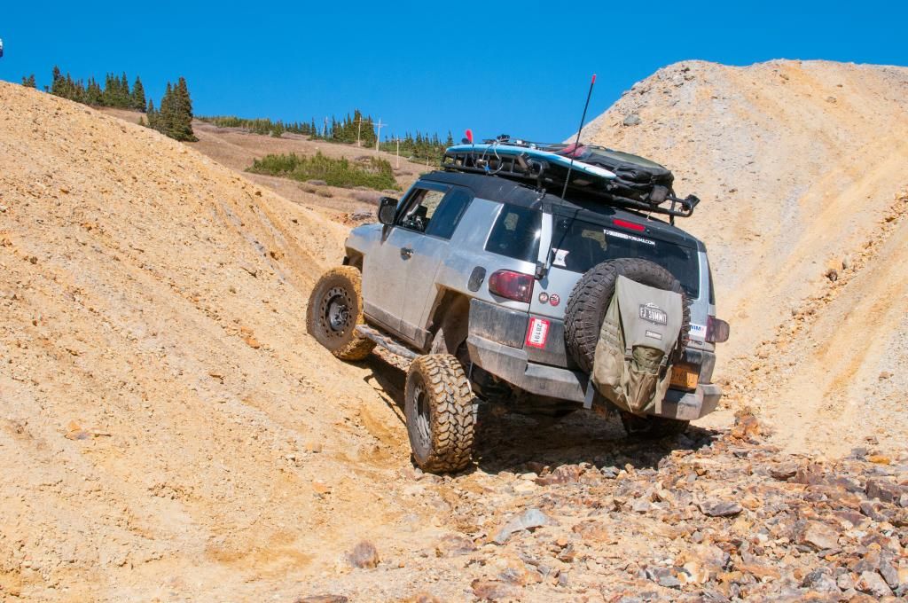

Used with some extended sway bar links (Skyjacker P/N SBE702) that allow for extra travel over stock, retain your rear sway bar (for us daily drivers), and the the links also keep the suspension droop limited in severe flex situation as Cashnutz73 found out. This was his initial post.
Did someone ring? The autoguide app is taking an extended vacation so I haven't been on much the last couple days.
Correction on the shocks. I was running OME 80 series shocks that I thought were for the front. I broke one after it came loose and had to get new ones.
The ones I received from TRDParts4U are labeled as 80 series rears. I was running those shocks with OME mediums. At full extension the tops of the springs would come loose. I moved to the Toytec Superflex springs and OME 80 series rear lifted shocks at the same time. When we set the truck on the ground I noticed that I had lost a slight bit of ride height. I put the OME 10 mm rear spacers in that I ordered. We had to compress the spring to get them in but it put the ride height back. Full droop was limited by the swaybar and not the shocks. I put the Skyjacker extended swaybar links on and I tested the flex and it seems to be good. I havnt been wheeling yet with the new springs and shocks.
I have been running the 80 series shocks for 2 1/2 years. I had to add spacers because the tires rubbed the inside of the wheel well at full stuff. 285/75/16. This also slowly deteriorated my sway bar end links.
