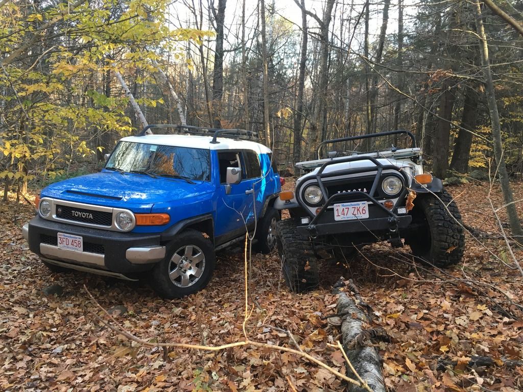

First wheeling trip out. Found the FJ's cousin (with a 454 in it!)

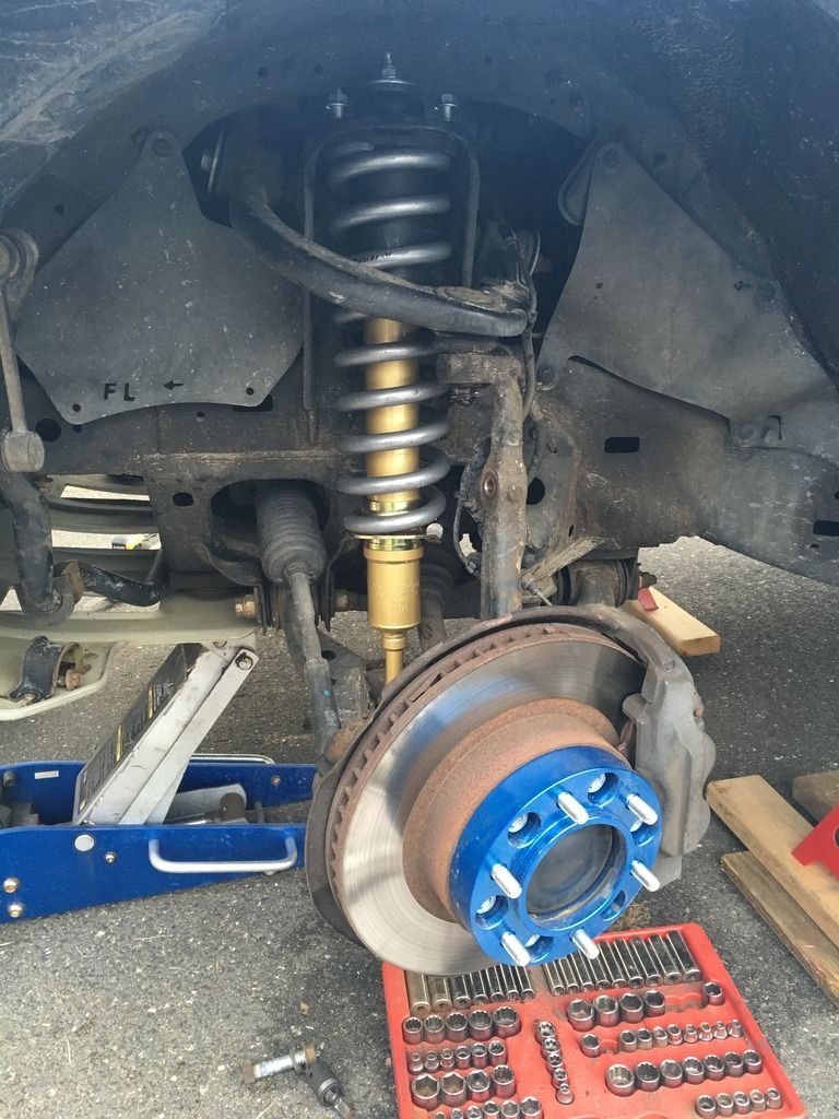

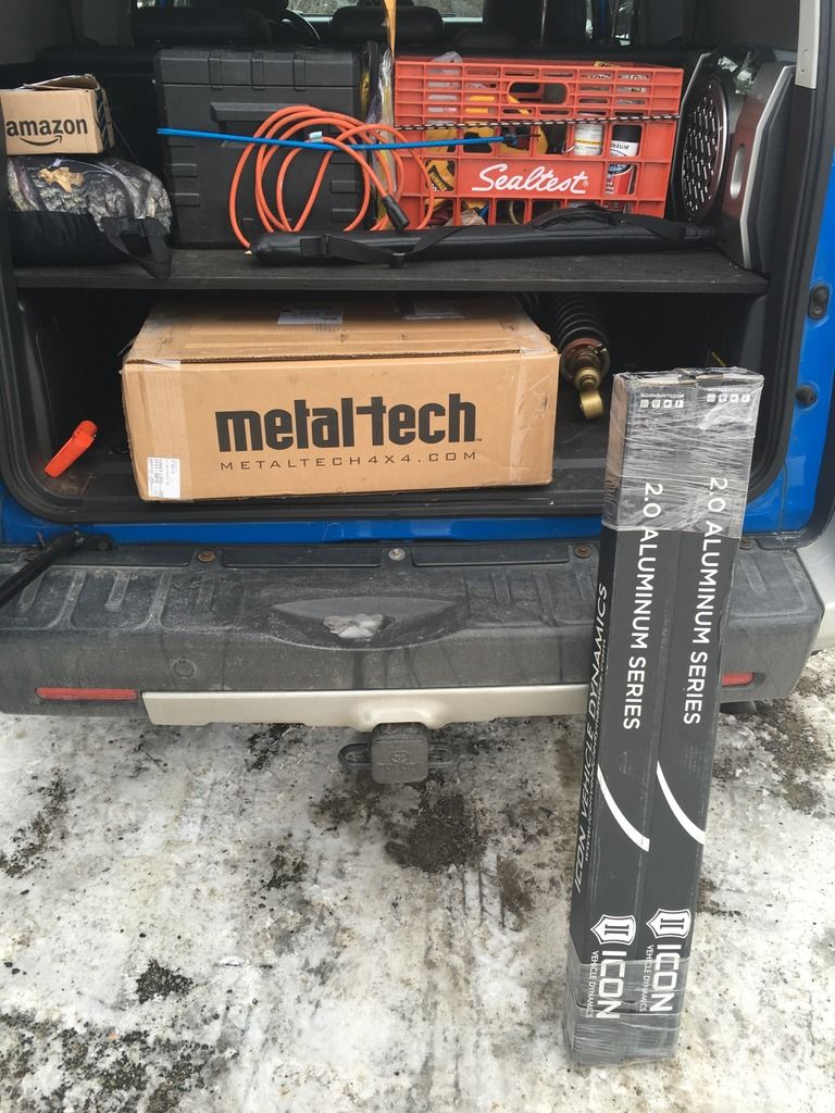

The first round of suspension goodies! MetalTech Long Travel rear, and TJM lift struts with 650lb Eibach springs.

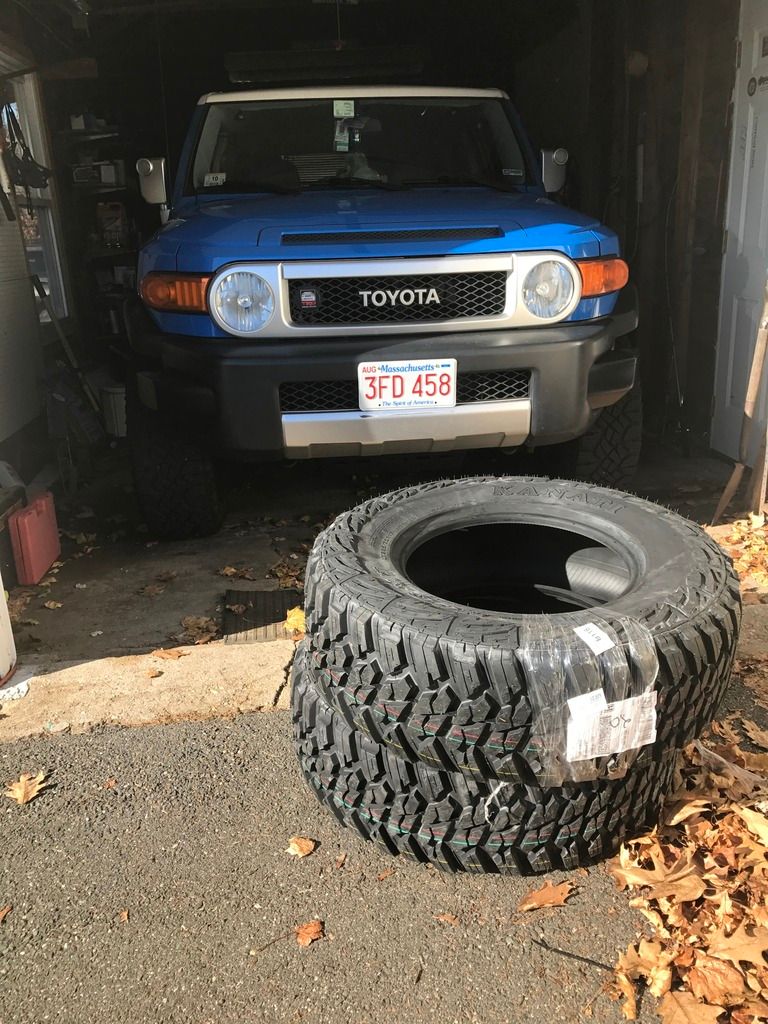

The first round of 285's (picked them up cheap used). Loved the Duratracs, but god they're expensive!

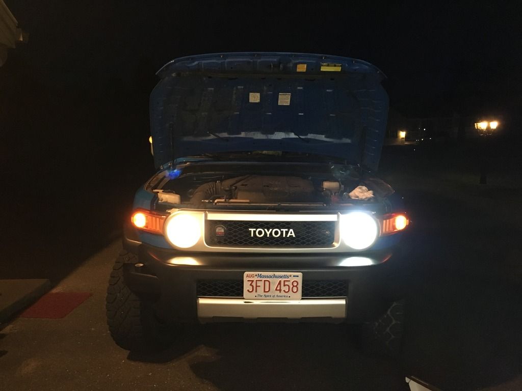

Lifetime LED headlight(s) installed. What a difference! I'd venture to guess 20-25% brighter than OEM.

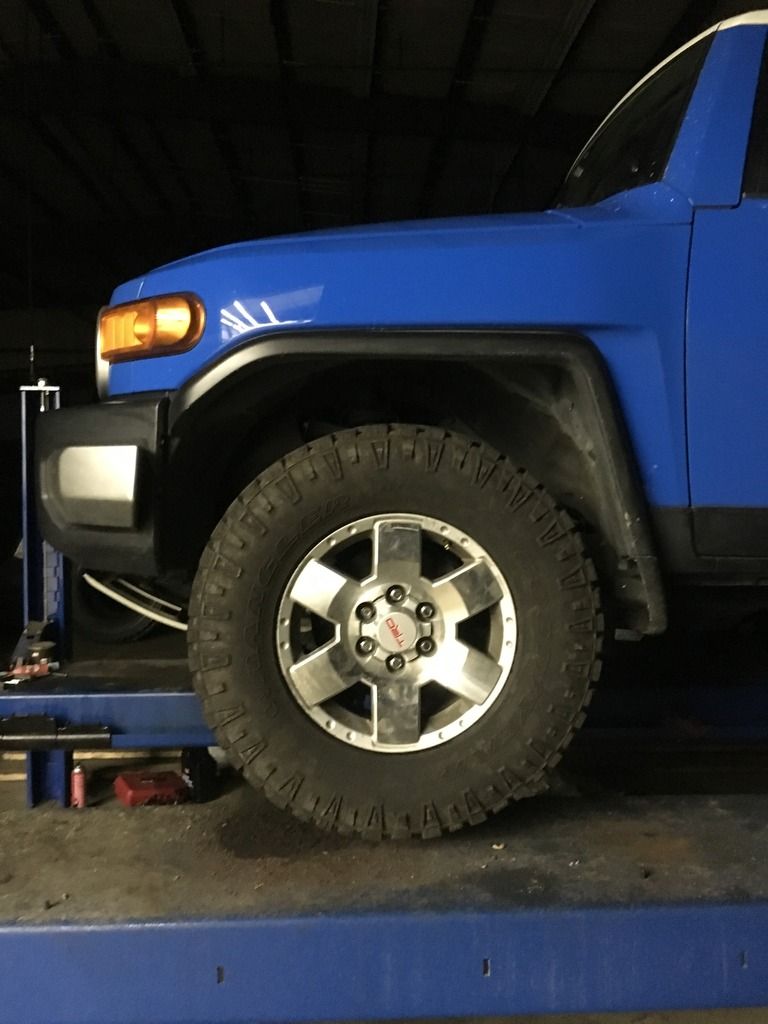

New shoes! 285 kanati mud hogs. Dirt cheap (~$180/tire) and wicked tread, give them 7.5/10 after 5 months of use and several major snow storms.

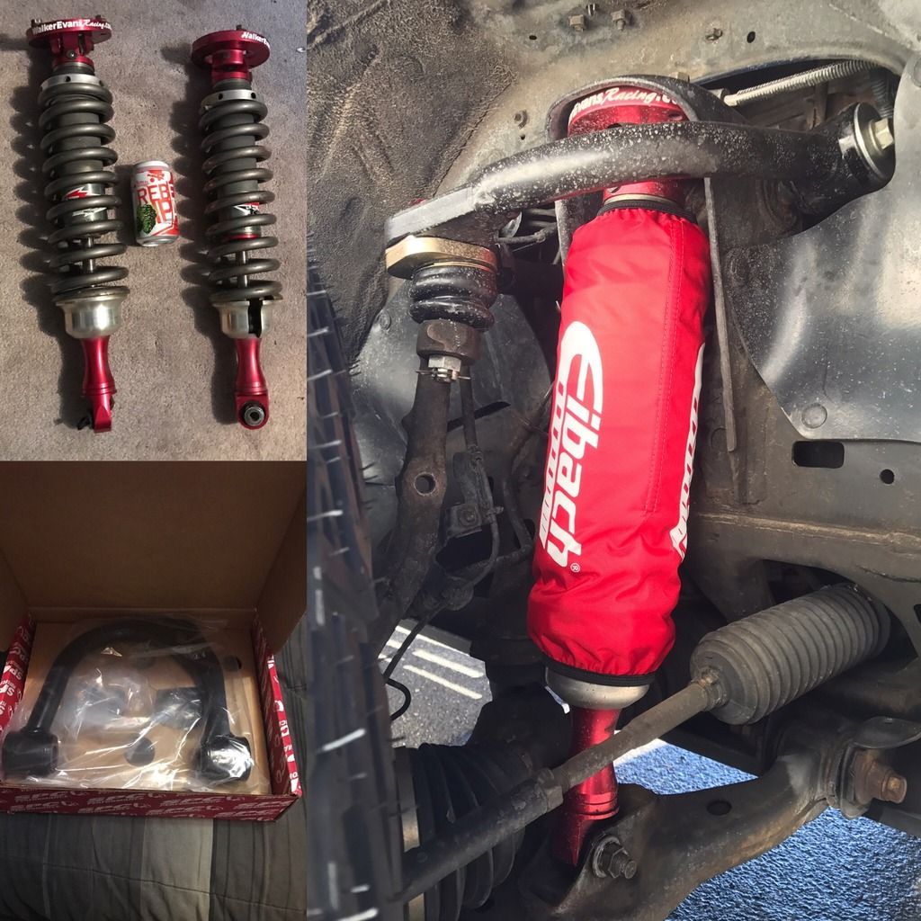

The second round of front suspension goodies. Walker Evan's 2.5 coilovers (AllPro- discontinued) with 650lb springs and Light Racing adjustable control arms (set to +2.0°). Ditched the sway bars. Also added coil wraps for the winter, I hate NE salt...
