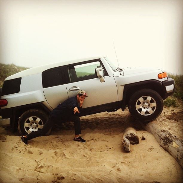

I bought the FJ from apple Honda in April 2013
Here she is stock, (not me in the photo :lol:)
