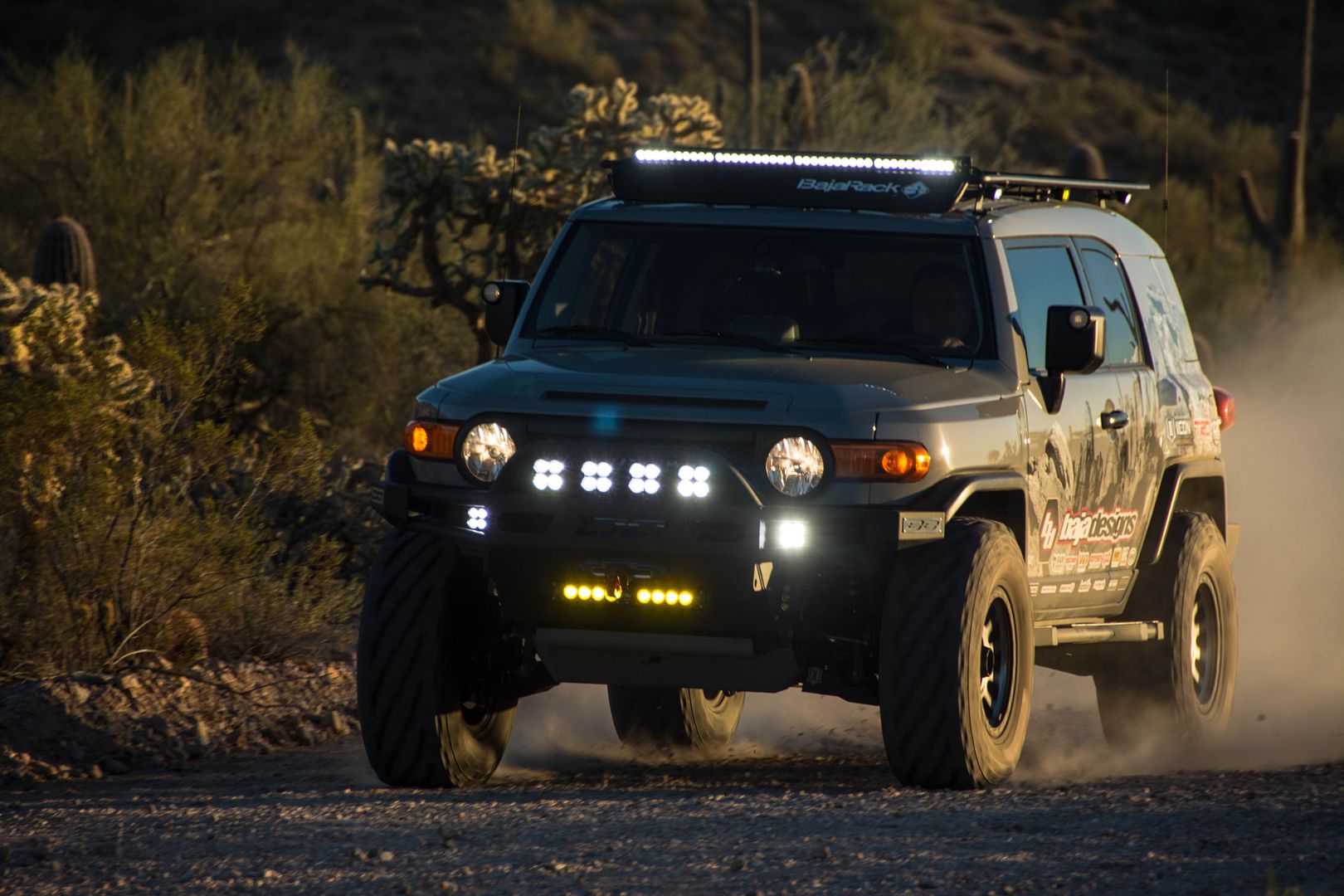

2013 Cement TT. Notable mods that are new to me are, Crawl Control and Rear View Camera
"The Rock"
Welcome to The Rock Offroad
It seems like I rack my brain trying come up with a a name and the meaning behind it. This time it was simple, FJess, thought it looked like a rock . Thank you Jess.
Current pic, as of 9/23/13
Updated picture November 3rd 2013, the night before leaving for SEMA
Featured at
Overland Expo May 2013 Flagstaff AZ
SEMA Booth , November 2013 Las Vegas NV
TCT Magazine January 2014
Overland Expo May 2014
FJ Cruisers Summit July 2014
Poster feature for Demello Offroad
Webpage cover Baja Designs
Brochure cover Baja Designs
