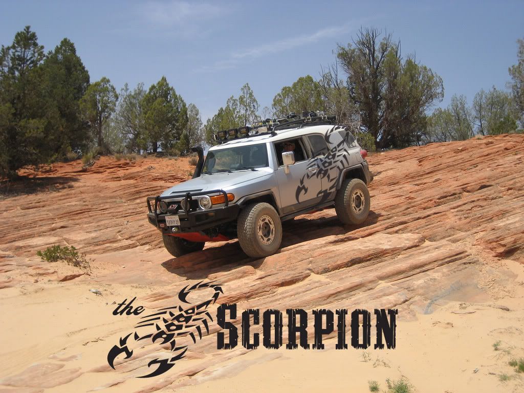

The Scorpion FJ, though unworthy of the man, has been created in honor of T. E. Lawrence (1888-1935), may he rest in peace.
When I bought the FJ, I mapped out a philosophy on which direction a build-up should take. My philosophy was built around a vehicle that could operate, removed from populated areas, and support my interest in exploration and examination of unsettled regions (increasingly difficult to find). Sometimes the questions are complicated and the answers are simple.
My philosophy in modifications is simple. I wanted to create a strong, capable, sustainable rig that would BRING ME HOME at the end of the day. Everything I've done to my FJ has that particular end in mind.
My favorite FJ Cruiser Moment: I'm driving my FJ on an expedition and I can't fall asleep at night under the stars because reality is finally better than my dreams.
This is the stock FJ.
I bought my FJ Cruiser on December 23, 2006 as a Christmas present to myself since it was highly unlikely that anyone else would buy an FJ for me no matter how hard I tried to get off the naughty list.

Engine bay bulges/rips: First noticed 1/21/08 - bulged on both fenders @22K miles
Significant Mechanical Problems: None so far
