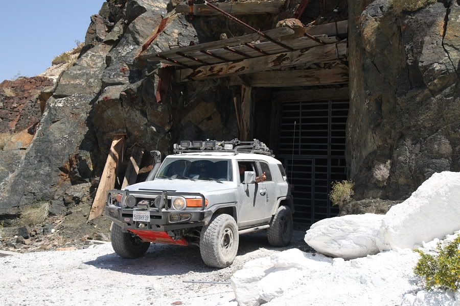

FROM THE DEALER
2007 Toyota FJ Cruiser Model 4704C
Titanium
Upgrade Package 1 <ATRAC/Rear Locker>
CQ and C7 Convenience Packages
Curtain Shield Airbags
Roof Rack
Build Date: November 2006
Engine bay bulges/rips: First noticed 1/21/08 - bulged on both fenders @22K miles
Significant Mechanical Problems: None so far
  • ARMOR
  • ARB Bull Bar - Front Bumper
  • DeMello Offroad rear bumper w/swing arm[/COLOR])
  • Bud Built Front Skidplate
  • Bud Built Middle Skidplate
  • Bud Built Transmission & Transfer Case Skidplate
  • Bud Built Rear Crossmember
  • Bud Built Fuel Tank (Beefy) Skidplate
  • Bud Built ARB Spacer Armor Plate
  • Inchworm E-Locker Motor Skid (sustained trail damage, cut down in size to repair)
  • Rear Lower Shock Skid
  • Rear Trailing Link Skid
  • Rear Differential Plate (welded)
  • DeMello Hybrid Sliders
  • Manic Tail Light Guards (Real Wheels guards took 5 trail hits -saves- then gave up the ghost)
    SUSPENSION AND TIRES
  • Walker Evans Beadlock Rims
  • Nitto Terra Grapplers - 305/70R17
  • Demello Frame Chop
  • Donahoe Racing Shocks and Front Coil-Overs
  • Old Man Emu Heavy Duty Rear Coil-Overs (OME-886)
  • Donahoe Racing Upper Control Arms
  • Light Racing Jounce Shocks (Chubbies) replacing bump-stops
  • Icon Signature Lower Control Arms
  • Gorilla Lugs
    EQUIPMENT ADDITIONS
  • Lowrance Baja 540C GPS & Freedom Maps Chip F103EX-S and F104EX-W & Shadow GPS R/V Mirror Adaptor Mount
  • Man-A-Fre Auxillery (22 gal.) fuel tank
    --Providing a total capacity of 40 gallons
  • Wet Okole Seat Covers
  • Scanguage 2
  • K & N Air Filter - Replaced by OEM Air Filter
  • Aux. Optima Yellow-Top Battery
  • Dirty Parts Auxiliary Battery Kit
  • Circuit Boss 7 Circuit Fuse Block
  • 6 x REL40 40 Amp custom amber switches
  • Stebel Nautilus Compact Air Horn
  • Passenger-side arm rest
  • Fuel Can Options: 2 x Wedco Jerry Cans (gas/water)
  • Relocated Rear Differential & E-Locker Breather - Scuba Driver Mod.
  • Fire Extinguisher
  • ARB Safari Snorkel
  • I-Pod
  • Death-Stalker Scorpion transfer case shift knob
    COMMUNICATIONS
  • SPOT Satellite Personal Tracker
  • Midland 75-822 Handheld CB Radio with Vehicle Adapter
  • Antenna – 5' and 3’ Firestick/CB
  • Yaesu FT-1802 M/E 2 meter transceiver (50 watts output)/HAM
  • Comet 3D5M mobile mounting hardware/HAM
  • Antenna - Diamond NR-770HA 2M/70CM 3/5.5dB Mobile Antenna/HAM
    LIGHTING
  • Airflow Headlight Covers
  • Hella Black Magic 6” Driving Lights (mounted to ARB Bumper)
  • N-Fab Front Light Bar/Bracket w/3 x Acro X1870M Driving Lights & 2 x 40 B/U PIAA Flood Lights
  • N-Fab Rear Light Bar/Bracket w/2 x 40 B/U PIAA Flood Lights & 1 x LEDQUAD LED Strobe Light Bar
  • 2 x Oznium Flexible Super Thin (red) LED Dome Lights
  • 2 x Puck (white) LED Dome Lights
  • LED Red dash lights replacing white instrument gauge lights
    TOOLS & TRAIL EQPT.
  • Fiskars Axe
  • Short Handle Shovel
  • Crowbar/Pry Bar
  • Eagle Talon (RJM Forge)
  • Husqvarna 350 18" Chain Saw
  • Jumper Cables
  • Tool Kit
  • JB Weld
  • Spool (1000 ft) OD Green Parachute (550) Cord
  • Roll(s) of 100 MPH Tape (milspec rigger's tape)
  • FJC Spare Parts Kit (on extended load-out): including 2xCV Boots, 2xCV Sway Bar Links, Serpentine Belt, rear lower control arm, front axel, spare fuses, tire valves, etc.
    GEAR STORAGE
  • SCORPION MOUNT - An endoskeleton in the back to provide hard points and additional M-PAC storage.
  • Pelican Cases - Allow modular load out depending on the nature of the trip.
  • Fourtreks Shovel/Axe mount
  • Fourtreks HiLift Jack Mount
  • Fourtreks Dual Mount
  • Fourtreks Fuel Can Rack Mount
  • Fourtreks Modular Roll Bar Handle
  • Springtail M-PAC rack and MOLLE gear
  • Springtail M-PAC Side Rack
  • 2 x Expeditionware Jerry Can Holders (currently one mounted)
  • Power Tank Roof Rack Mount - (Custom Fab using Four Treks parts)
    PNEUMATICS
  • 20 lbs. CO2 Auxillery Tank (Internal Mount)
  • 10 lbs. CO2 Power Tank
  • Ingersol Rand #2135 Ti (composite titanium) pneumatic impact gun
  • Power Tank Super Coupler
  • Power Tank HD Tire Inflator Handle
  • Oasis Trailhead Deflator / Stebel Trailhead Deflator (both onboard)
  • ARB Tire Repair Kit
  • Spare valves and valve cores
    RECOVERY
  • Warn XD9000 Winch
  • Viking Kevlar Winch Line (100')
  • Winch Safety Thimble
  • Viking Delrin Fairlead Rollers
  • Warn Hitch Shackle
  • 30’ Rescue Strap
  • 100’ of braided steel cable
  • ARB Snatchblock
  • Pull Pal
  • 4 x 3/4 ton D-Rings
  • ARB Bushranger X-Jack
  • Hi-Lift Jack
  • WabFab Slider Attachment
  • Hi-Lift Jack Base
  • Hi-Lift Jack handle keeper
    EMERGENCY EQPT.
  • Basic Survival Kit (on standard load-out)
  • Large First Responder First-Aid Kit including an adult bag/valve mask
  • Smoke Grenades (pyro- red and green)
  • Chemlights (red and green)
  • Polish Model 78 Flare Gun (26.5 MM) with star flares
  • Lensatic Compass
  • Knive(s)
  • Firearm(s)
RECOMMENDED VENDORS:
I have had consistently good service from these
vendors and encourage you to consider them in
your build-ups. I have not received a discount
from any of them and have no financial stake in
the outcome of your purchase.
DeMello Offroad
BudBuilt
Man-A-Fre
Springtail (MPAC)
Dirty Parts
