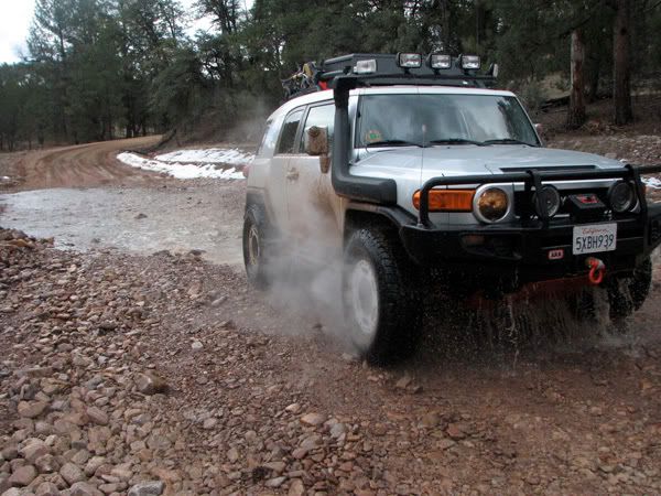

This is the stock FJ.
I bought my FJ Cruiser on December 23, 2006 as a Christmas present to myself since it was highly unlikely that anyone else would buy an FJ for me no matter how hard I tried to get off the naughty list.
My daughter Emilie agreed to ride shotgun with me on trail runs.
