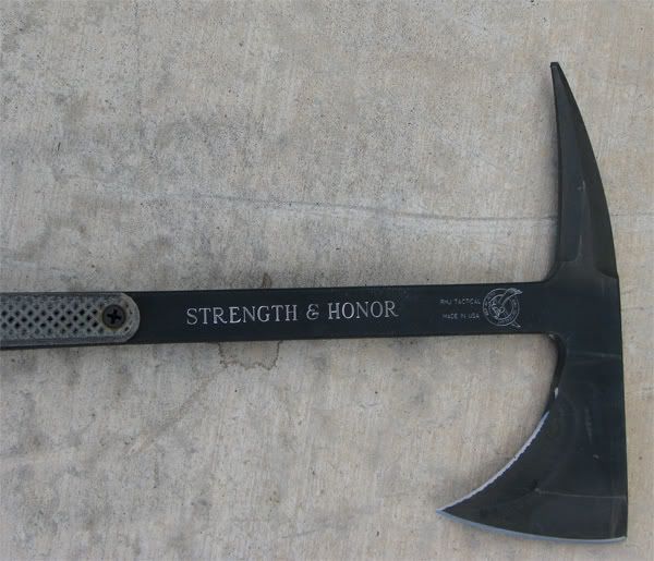

It has a little clip on the back so I guess that I could attach it to something. Right now it's in my go-bag in one of the velcro pouches. I don't plan to turn it on unless the world is coming to an end. It has an "OK" button. I can activate the contraption, hit the OK button and it will text message my kids and let them where on the planet I am and that I'm "ok". But that's only if I'm not in cell phone range. (if the phone works, I'll call and say Hi)
Actually it's a clever little device and if you're in deep trouble, not a bad thing to have. My nature is such that I'd be VERY reluctant to activate it. Better to sling the ruck, canteens, firearm(s) and walk out IMO. I've done it before and I don't feel like a panzy. Frankly, setting off a satellite beacon (in my mind) is not unlike the little old lady on the TV commercial screaming "I've fallen - and I can't get up."
Still there could be a time, particularly if I came on somebody who'd been in a car wreck or something when I'd want to push the 911 button.:bigthumb:
I have one and just used it for the first time in the backcountry in Yellowstone last week. I have the tracking feature and it worked great for people to see where we were (sends a location every 10 minutes). I'm like you, would rather hike out if at all possible. I'm fairly spontaneous and change plans often, so one of the benefits for me is I can send out an OK message as I start a backcountry trip and someone will know where I am if I deviated from my planned trip.

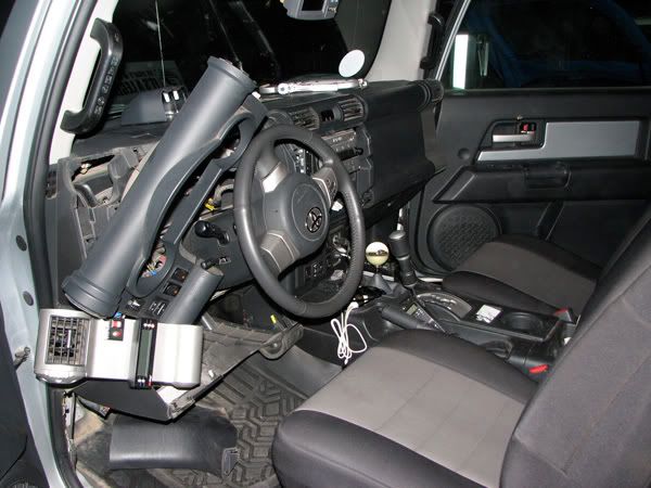

TINCUP installs red LED dash lights in the Scorpion finishing just before midnight.
Destroying the dashboard.
Evidence of the extent of destruction.
The new red LED's are wicked!

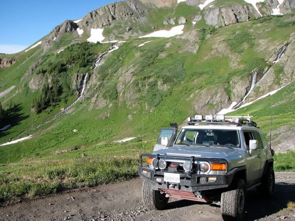

YANKEE BOY BASIN
SHADOW WARRIOR led our motley band of FJ's from Ouray at about 8000 feet to the top of Yankee Boy Basin at about 11,500 feet.
The group consisted of Mr/Mrs SHADOW WARRIOR, DRAGON & FJSOHOT, the SWICAGO Family and MRSUPHILL riding shotgun with me in the Scorpion.

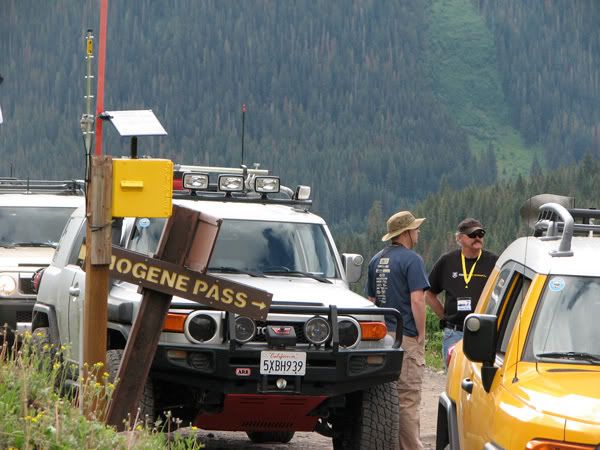

Imogene Pass
(Ouray to Teluride)
I was toward the end of the trail run, led by MUDDYGRRL.
MOUNTAIN MAN (Taft) was immediately in front of me on the trail. He's a very good driver and showed that an almost completely stock FJC can kick serious butt on the trail.
On the road to Imogene Pass.
SHADOW-WARRIOR was right behind me in the tail gunner position. In this photo, the Raptor is following the Scorpion!
Well above timberline, there is still considerable snow.
Another shot of the snow fields at about 12500 feet on the climb up to Imogene Pass.
MRSUPHILL poses with me at the Summit of Imogene Pass.
The next group of FJC's climbs to the Summit behind us.
A pause for the cause on the downhill side of the trail. (group photo)

TIE ROD ISSUE
I suspect that for many who are running near-stock rigs this won't be an issue but those of us who are exceeding Toyota's design parameters need to at least pay attention.
I ran the Kokopelli Trail with TCAO, JESHUA, FROGEYE, etc. last week. At one point I hit a dip a bit "hard". Thereafter I had some "squirly" steering, as if I'd removed the front sway bar. I stopped and looked at the front end, checked for obvious problems and didn't see any. DRAGON and SHADOW-WARRIOR walked up and I ran it past them. We had dipped into some gooey mud a half mile previously and we counseled that it might have something to do with mud in the wheel.
The steering was still "wrong" and all the way home, there was wandering, erratic steering on the highway. It still felt loose. Not linkage loose, just loose. Somehow wrong.
I'll make a longer story short. The tie rods weren't bent but the inner ends of the tie rods were shot. Therefore the erratic wandering track on the highway.
The explanation is straight forward. I have wazoo Icon suspension, Light Racing jounce shocks, and run the truck with heavier wheels and tires. The tie rods are the weak link in the system. They're stock. Modifying this part and that part without completely redesigning the vehicle cause these sorts of maintenance issues.
I suggest you check the tie rods every so often. Mine survived 32K miles and then gave up the ghost.
