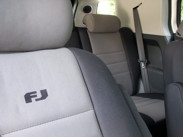

Wet Okole SEAT COVERS
Note the red rectangle because it marks another mod/addition to the FJ.

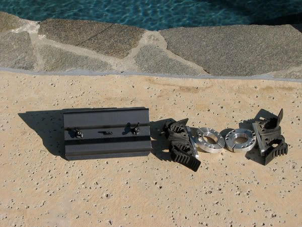

WORK TOOL
It's important to have tools handy. In this case, a multi-purpose tool for off-road conditions.
An axe for cutting down trees, a pick function for prying loose rocks that get in my way.
And a cover when it's not in actual use -- safety first.

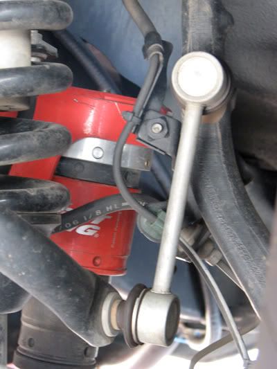

ULTIMATE SWAY BAR LINKS
From All Pro
OEM Link, skinny as a frog's leg.
Linkless
All Pro Ultimate Sway Bar Link installed -- painted red and white, of course. Don't tread on either me or my sway bar link!
AFTERMATH - FIRST TIME OUT!
I was very proud to get those Ultimate Links. DUSTPARK, THUBUB and I were even at All Pro trying to be the very first FJ owners to get them on to replace the OEM links. And when mine arrived, I painted them because I was darned proud of them. Scorpion's Ulitmate Link Installation
WHAT HAPPENED?
I took my FJ off-road with WRIGMAN, HIGHBEAMS, JEEPERS, DOMINICG, MUDLOVINGFJ, RICOVERDE and others in the Cleghorn Trail run last Saturday. I drove home and the rig wasn't handling right but by the time I pulled into the driveway it was dark. Sunday morning I caught the 6am flight to Florida for work and didn't get back until today. The first thing I did is look under the FJ for the "problem" and this is what I saw:
Left Front Link - Missing, but the heim joints are still there bolted in.
Even though I used Loctite on the bolt, you'll see that it is way out of adjustment and just about ready to come apart. Maybe I didn't use ENOUGH Loctite - you can be the judge of that.
The repair bill for the damage caused by these defective links was $332.08 for two damaged/destroyed CV Boots (@ $69.68) and labor (@ $255.00) + tax. I sent a request for payment to All Pro on October 10, 2007.
THE PART FAILED THE FIRST TIME OUT.
And as we all know, misery loves company - SAVVYAV'S ALL PROUltimate Sway Bar Links failed while he was driving to the movies, having never taken them off-pavement.

Shovel and Axe Carrier
There are a number of solutions, some are made inexpensively by people for their FJ's. Others are not so inexpensive and the option I have gone to is the latter. I had a Fourtreks system, pictured on the right below. The rubber straps just didn't hold the gear in place as well as I wanted on long trips and in rough, off-pavement/off-road situations.
I went to the All Phase Offroad carrier solution which is extremely heavy, holds both the axe and shovel in a solid mount and is lockable (pictured left above and below).
I have a planned use for the Fourtreks clamps and will post that solution when and if it works for your review.
