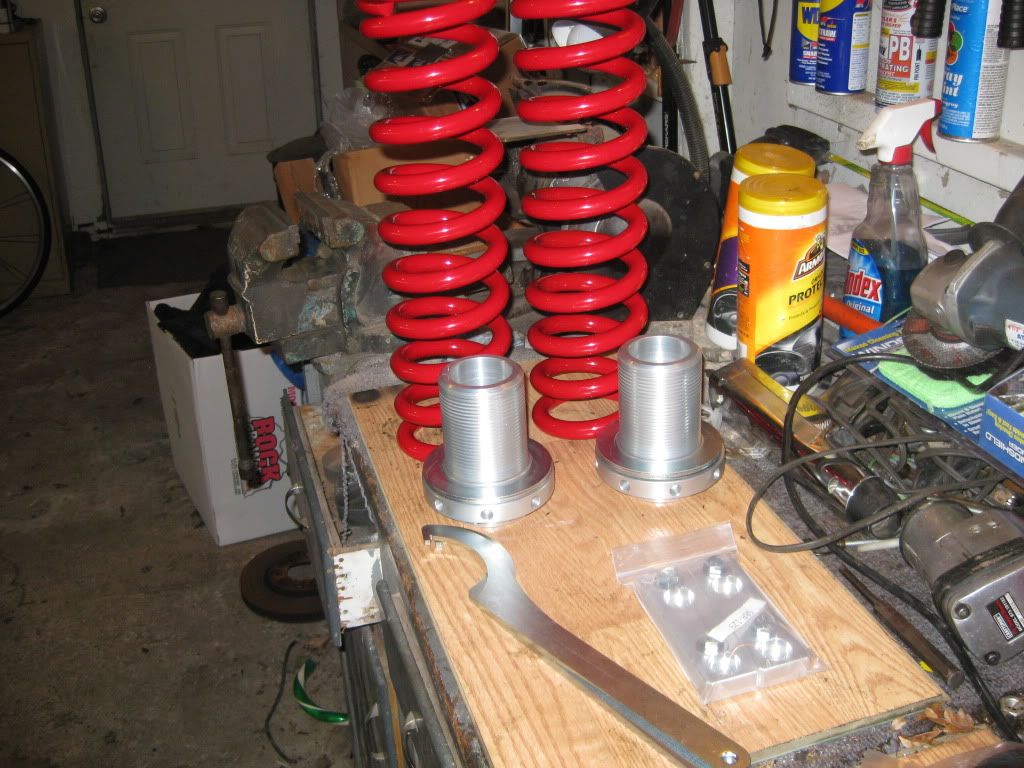

I think the aluminum top collar thing you're referencing is only on the toytec ultimate kit. I do remember it is etched with "TOYTEC". Here is a pic of my crap all laid out the day I installed it. If you want tomorrow I can go get a close up picture of what you're talking about.
I think I know what they look like I just would like to have the collars someday LOL thanks.:thinkerg:

also i see that the rear springs are red in this pic did you asked for red springs or paint them red? there black on the Toytec site :rocker:
