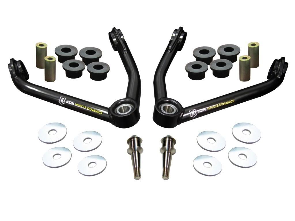

Uni-balls have a few advantages over ball joints. A couple of them are:
Stronger (for equivalent size)
More range of motion
Can move more freely.
Some uni-balls can be prone to squeaking if you are not diligent about keeping a teflon style lubricant on them.

Billet aluminum used for UCA vs DOM tubing is just for bling factor IMO. It could be stronger than DOM tubing, but no one even bends the stock UCA, so a non-issue.
ICON is the only one making billet alum UCA as far as i know.
In addition to using a uniball, the ICONs also use johnny joints to attach to the frame (which are better than poly bushing)
ICON vs OEM Toyota
The basic main differences in prices are:
Ball joint vs uniball (uniball is more expensive)
1" uniball vs 1.25" uniball (bigger ball is more expensive)
Quality of components
Materials used
Just to touch on the poly bushing issue:
If you are doing a front suspension install, when you disconnect the spindle from the UCA, pull the UCA down and let go. It is going to spring back into position very quickly due to the bushing in the OEM UCA.
On the other hand, if you did the exact same thing with the ICONs, they move up and down much more freely and do not have any binding since there is no bushing, but rather a johnny joint (or at least that style joint).

Thanks for the info so far, I've added pictures and some more info to the OP and will continue to do so. I also added a second Total Chaos since they apparently make both adjustable and non-adjustable UCAs.

Don't know if I agree with the johnny joints being "better" than the poly bushing as both will move freely unlike the stock rubber bushing. That aside the non poly applications could possibly reduces mess due lube material and process of application, IDK.
IMO just about all of the chromoly sets will do what you want them to do. Have never heard of anyone having issues with build quality or trail breakage although I do not have data on the tubing from part to part.
