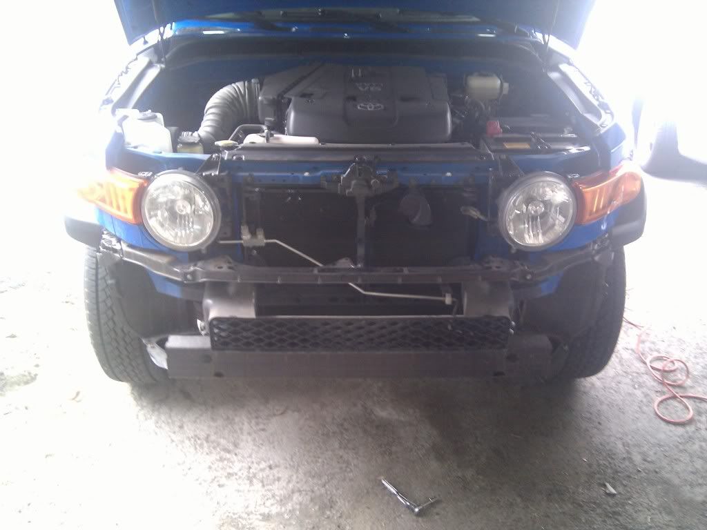

Remove your bumber:
Remove the mesh. It is held on by two plastic push pins on either side:

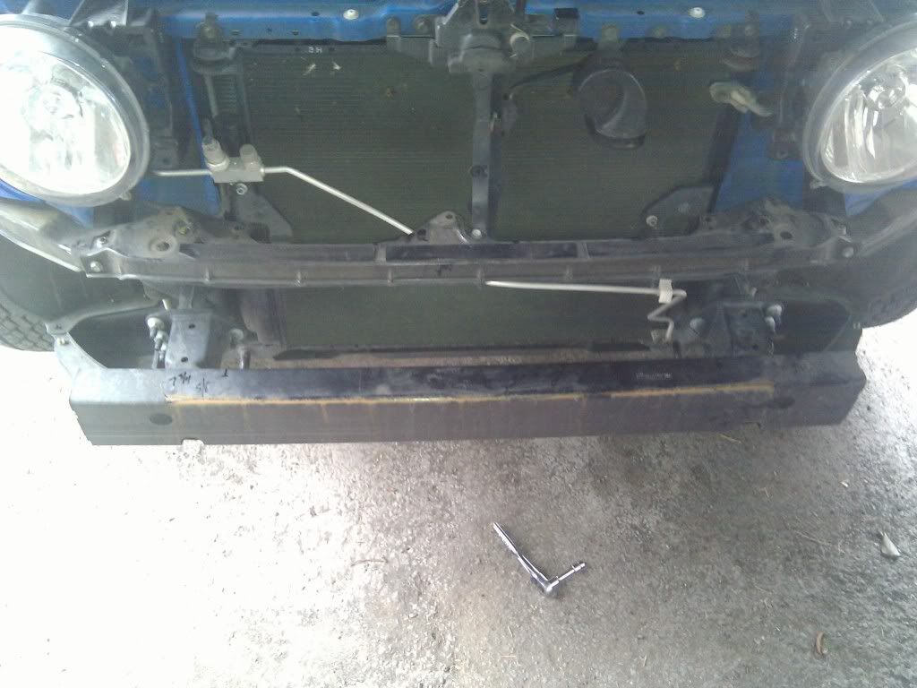

Remove the upper bumper attacgment point. Three 10mm screws hold this on. One in the center, and two on either side. Easy:

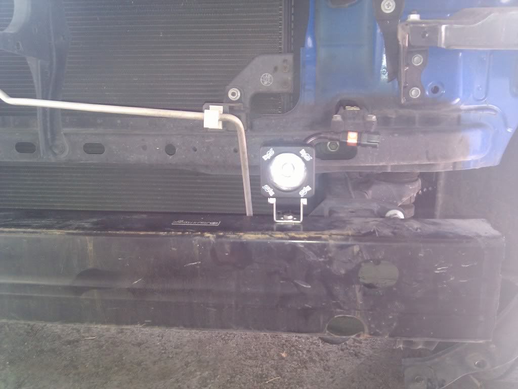

Now that you have your bumper beam fully exposed, measure for your mounting holes. I measured in from the edge 7 and 3/4 inches, and 5/8 from the back. You dont have alot of room front to back for the lights. any closer to the front and the mesh grill will rub on the front of the lights once you reinstall it.
You can also measure farther in from the sides if you want your lights closer to the middle. In Tejas we have to run a front license plate and I wanted them close to the outer edge of the grill. Another thing to consider, if you mount you lights any further inboard you may have to cut access holes into the bumper beam to facilitate installing the nut on the bottom of the mounting bolt.

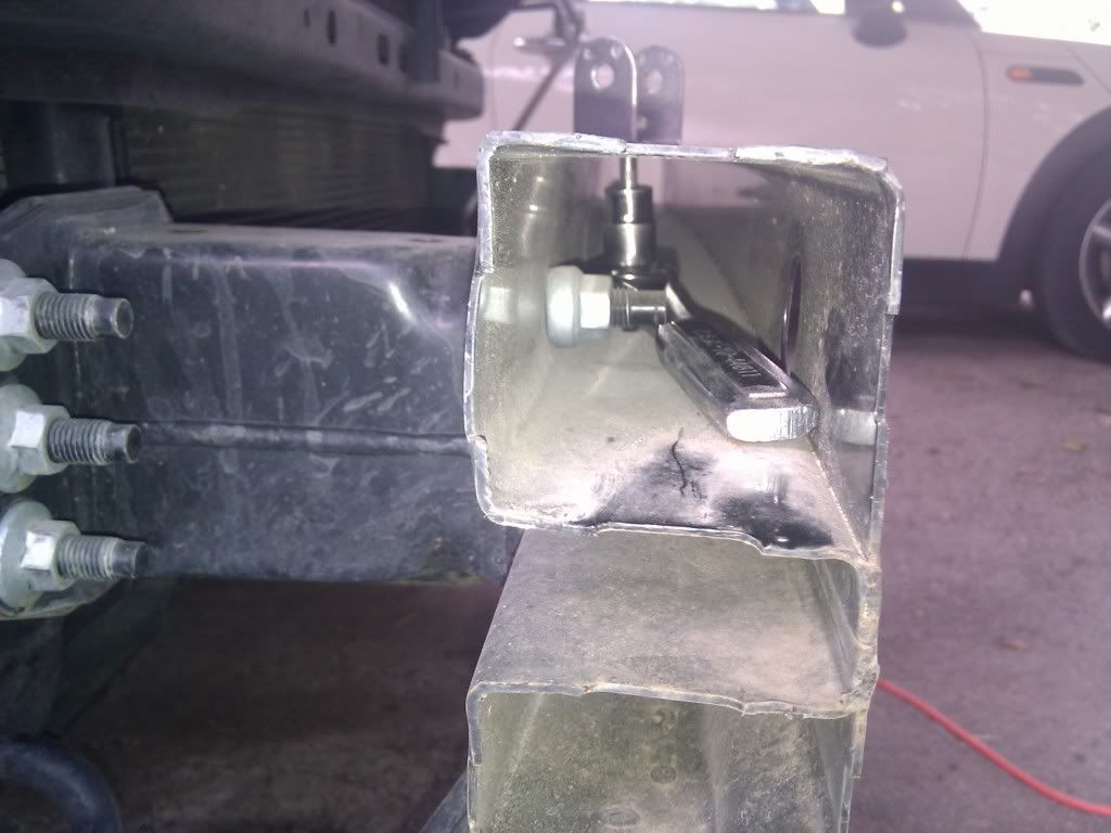

Drill your holes where you marked and then stick the included bolt and bracket through the hole. The way I tightened the nut from the bottom is as follows. I used a ratchet and socket to hold the nut on the bottom and tightened from the top. Its a tight fit to get it to work, and as the nut got tighter i had to wedge a wrench under the ratchet and pry it up to maintain contact with nut. Between the hole in the front of the bumber, and the hole in the side, it will work.
Get the bolt almost all the way snug. The bracket will spin as you tighten. Once you get it tight enough it stops spinning, whack it with a hammer to make it straight and then snug it down all the way.
Pictures of how I got at the bolt to tighten the nut:

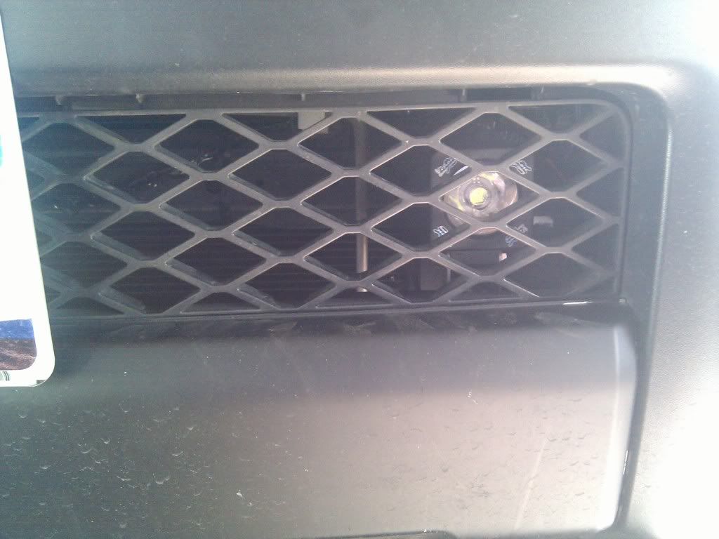

Here they are mounted. I love how small these are.
Now that they are aimed properly reinstall all the stuff you took off.
Finished!

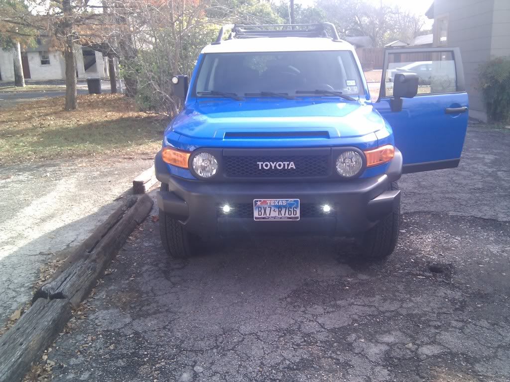

Night
Night shots.
These things are really bright. Even brighter than I was expecting. Obviously cell phone pictures dont do them justice, but you can get an idea.
Low Beams:
Low Beams and Solo pods:
