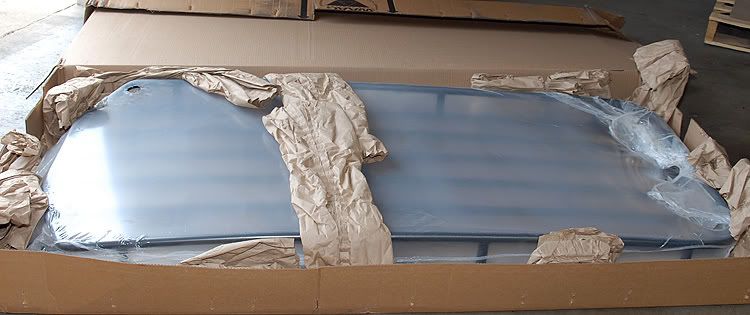

The rack was pretty well packaged and arrived in excellent condition..
It took a while to get the rack and hardware cut out of the plastic wrap, but once I did, this is what I found...

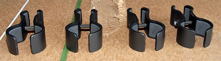

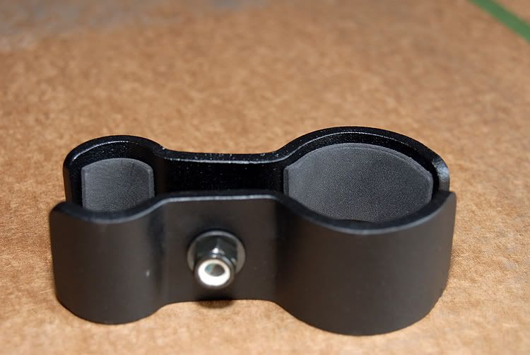

Once together the brackets look like this...

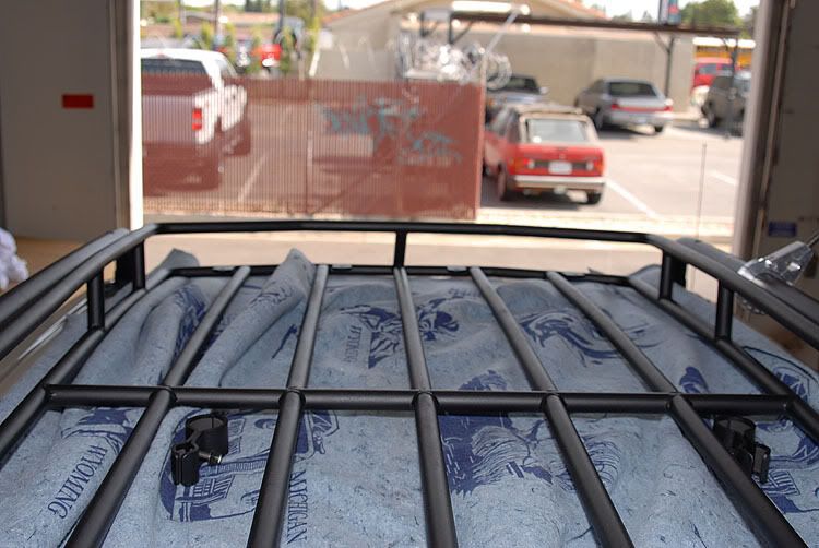

I think the hardest part of the install was getting the basket on top of the roof. This definately requires a minimum of 2 people, 3 is better. I also found that bringing the basket over the back of the rig and walking it forward worked best. Make sure you have a blanket that covers your entire roof under the rack to avoid potential damage to your ride and the XS.

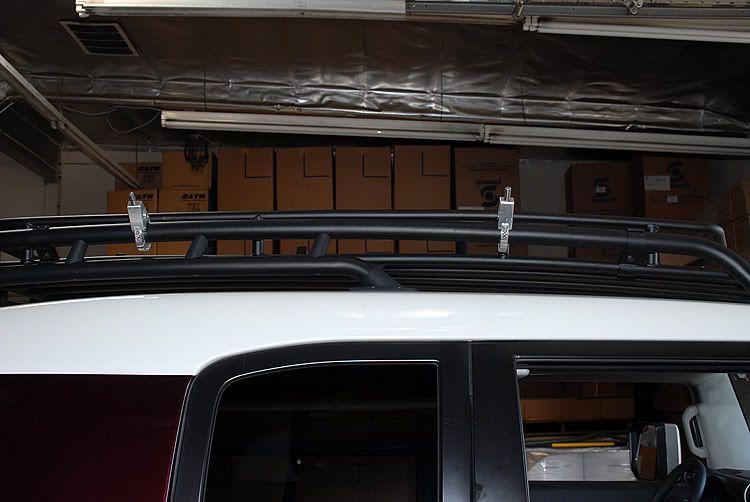

I was very happy to see that the basket fit inside the rack while I still had my FourTreks combo and hi-lift mounts in place. After spending the $$ on those mounts I was really worried that they would have to come off.

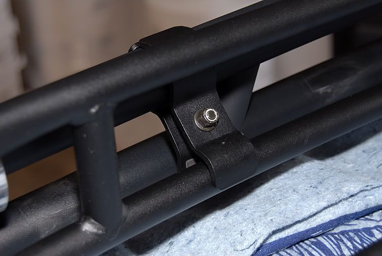

Once the basket is in place you can start placing the brackets. Having a second person on this step would make the process easier and faster. They could hold the basket in place while you get the bracket tightened. Remember to leave them loose so you can easily make adjustments when all the other brackets are in place.
The second hardest aspect to this install was getting the rack centered and level. Come to think of it, having an actual level probably would have made the process much easier.

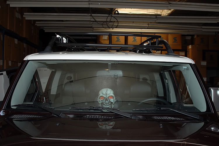

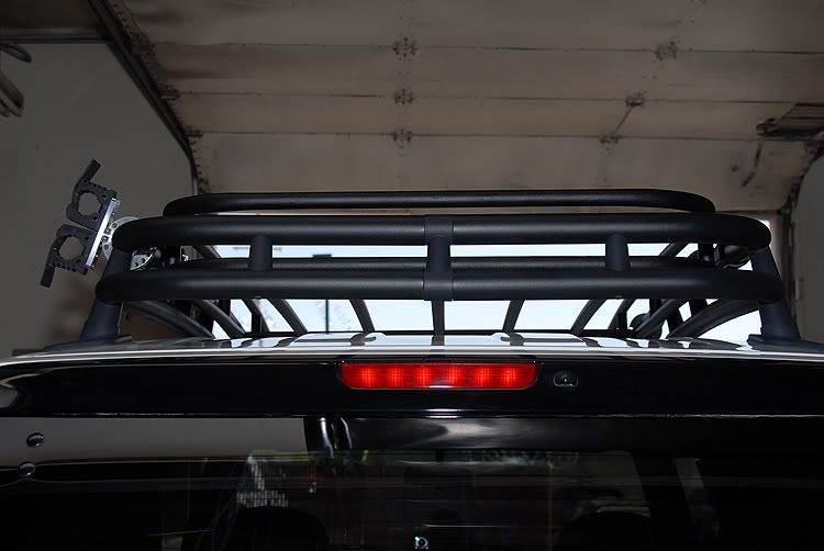

This is what she looked like after the install..
All in all, I think the basket looks great. CruiserLarry did a nice job with the design and WAAG did a great job with the fabrication. The XS looks like it came from the factory and incorporates with the stock rack beautifully.
A couple things I'd like to add..
1) I was under the impression that the basket would sit flush with the top of the rack. As of now, it does not. (And yes Poker, it is below the stock antenna.) Seeing the rack in person, I don't think it looks too bad sitting high, but I'd definately be interested in seeing how it looks flush.
2) I'd like to see a few more brackets included. I'm sure 4 is sufficient, but 8 (one more per side and two in the rear) would be make me feel better. I'm sure time and use will settle my concerns.
3) An Air-Dam and ladder would be nice options.. ((nudge-nudge, guys at WAAG))

Very nice. My question is how much higher will this rack add to the stock rack? I just want to make sure this will clear the low garage. Thanks.
Best I can tell, the basket sits 1.75" to 2" higher in the front and rear and 1.25" higher at the center.
I spoke with Mike at WAAG after posting the original write up and he confirmed that they will be lengthening the mounting brackets so the basket will sit flush with the rack.

I saw the rack addition in person tonight and the prototype is pretty nice! It looks fairly stock. I agree that it would look nicer if it sits lower, but I really don't see how it would still be able to clear the Fourtreks.
Tony, that was the first thing I checked.. The basket, regardless of how high or low it sets, will clear the mounts. My basket isn't centered in the rack (due to my laziness, not by design) and sets closer to the passenger side. Even when the rack is centered, there's room for the mounts.

Technically it does not "bolt" to the rack, it is attached using brackets which squeeze around the tubing, thus holding it firmly in place. Much like the FourTreks Hi-Lift mounts or the stock crossbars for that matter.
Total install should take less than an hour and really doesn't even require instructions. In fact, I'm guessing that if I took it off and put it back on a few times, I could get the time down to 15 minutes or less.
