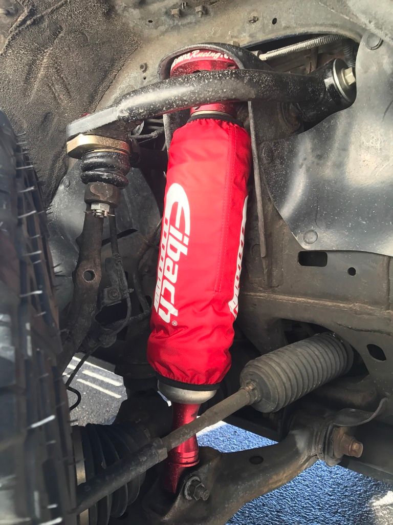

Finally installed my icon 2.5s and tubular UCAs. Next is to replace the lower ball joints and bushings, then the sway bar links.
Sent from my SM-G950U using Tapatalk
Reactions: 4
If you've got 2.5's on there ditch the sway bar altogether!
What would that do for me? Wouldn't I lose stability on the highway?
Your front sway bar is the limiting factor for flex in the front. Yes, you'll lose some stability but increase off-road performance. The idea with 2.5's being that the increased spring diameter and rate will counter (somewhat) the lack of a sway bar. I've got WE 2.5's and no sway bar, the only thing I do differently is I take curved highway on-ramps slightly slower now, no change in around town/slow speed driving habits. It's easy enough to take off and try for a few days to see if you like it, if you don't then put it back on.
Nice cover. Where did you get it?
See here (LINK - Kartek). Just choose the one with the correct dimensions for your coil.
thanks
WTF is wrong with your uni-ball? Pretty sure your not supposed to grease those.
https://camburg.com/shop/suspension/tri-flow-heim-uniball-lube/
I'll clean it up. I was planning on capping it with the Amsoil Synthetic Polymeric Off-Road Grease, NLGI #2 grease on top. Thanks for the info
