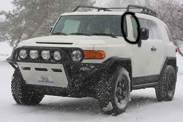

When you order the A pillar cover, make sure it comes with the 5 white clips (placed in the circled red in the picture below). If not, you have to order them too since you will surely breaks a few or all of them when to pry/pull the cover out.
I think you have it right, but I believe all Toyota parts (metal body panels that is) come in primer only, meaning you would need to have it match painted...

oh damn they don't come painted :( Mine got hit by a huge rock and took a big chuck out of it and it looks like crap.

oh damn they don't come painted :( Mine got hit by a huge rock and took a big chuck out of it and it looks like crap. i guess im better off just leaving it. to much work to get it painted and so on.

Pillars rocker and floor - Hinge pillar - Pillar cover Pillar cover Right 2007 - 2008
61110-35010 List $148.44 Your cost $112.81
RETAINER, OUTSIDE MO (5/per side) 75392-35210 List $0.74 Your cost $0.56
