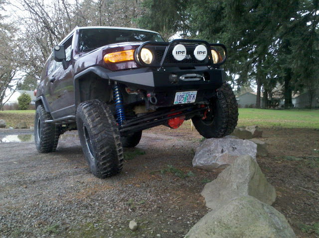

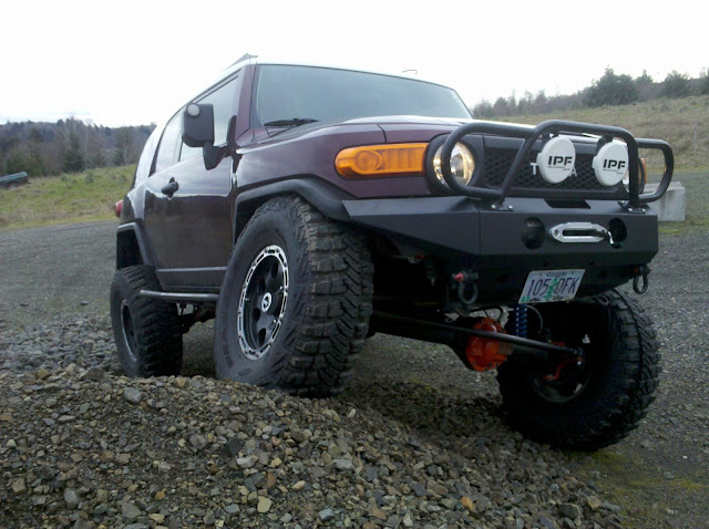

Larry,
Rig is looking GREAT! Looks like a behemoth next to those tiny Jeeps.
Do you have a build thread? I looked but didn't see one. I'd love to see the transformation and details of your solid axle swap. Looks like it was done really well. What axles, gear ratio, and size MTRs you running now?

High pinion dana 44
4.88 gears w/arb
fox 12" coil-overs
37 12 17 MTR
stock rear axle with 4.88 gears.
FJ 80 front springs
Larry
Nice!
Did you harvest the axle out of a Wagoneer or something similar or pick it up new?
Did i read that right? You have 80 series front coils on the rear of the FJ? Any particular reason for this?

I found the axle on craig's list. It's out of a 1977 or so ford 3/4 ton. The outers are chevy early 80's.
I needed about 5 "lift over stock and the landcruiser springs fit the bill.
