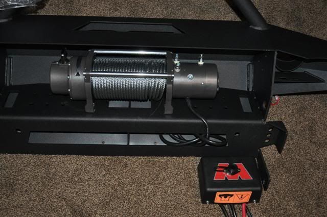

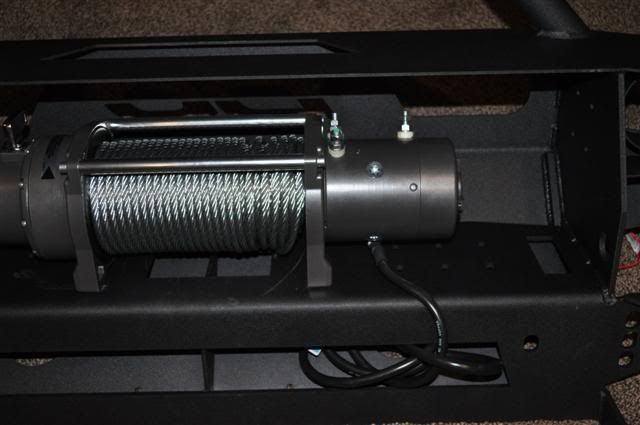

Ok, so here it is.... I managed to get the winch body mounted (no easy feat as there is a lack of access to the mounting points) but now my issue is that I have no idea where to mount the control box for it. Certainly nothing is jumping out at me for a solution but I cant imagine a bumper built for a winch wouldnt be compatible with a warn product. Obviously I am missing something here.
So if there is anyone with a Demello bumper that has mounted a winch I would really like to hear how you managed it.
Demello bumper
Warn m8000 winch

I mounted the control box/solenoid off to the side of the winch. I took a piece of sheet metal to sandwich the mounting bracket to the bumper. If I get a chance I will snap some shots in the morning.
The connector is accessible from the front of the bumper.

I mounted mine inside the bumper on the drivers side... It's a titan winch, so the control bax is aluminum, so I drilled some holes in the side of the bumper and bolted it in.. You could make a braket ot position yours where you want I sure, or bolt directly to the flat...

Thanks for taking the time to post pics and responding Bandi...
Unfortunately my cables coming out of the control box are to short to make the connection that is on the passenger side of the winch if I were to mount it on the drivers side where there is more room. I also like how your box the remotes connection is on the narrow side of the box instead of the biggest side of the box like warns.

Thanks guys for all the input! You got me to thinking about the different options and I finally came up with something that worked for me.
Using 2 large L brackets that I notched to fit snugly into the funky back plate of the control box...
I was able to use existing holes in the bumper to mount it to.
Once mounted, it set back from the front opening in the bumper just enough so that the plug for the remote is inset and pretty well protected.
Finished product all mounted up!
