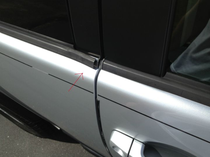

My Fj is missing window trim at the bottom of one of the windows, and on the other side it looks like it starting to come off.
Can I order this online and do it my self?
Any info is appreciated,

Toyota has the trim pieces. One of the supporting vendors can probably send them to you or you can go to a local dealer. They won't have them on the shelf so it will take a couple of days for them to arrive. Install is easy, no tools required. You just line them up at the bottom of the window and push down until they click in place. The one that is coming loose can be removed by pulling up. The plastic clips that hold it in place will break and some small bits will fall to the bottom of the door. Just ignore it and put the new one in place (it comes with new clips already on it).

Had the same thing happen to mine. I was too chicken to pull them off cause I didn't know new ones clipped back in so easy. So I super glued them back on. Holding fine but looking old and faded. Let us know how the install goes on the new ones.

Anyone know how much they are a piece at the dealer? Really need to get them, the other side fell off too.

List for the fronts is $20.86EA and the rears are $13.95EA.

As a temporary (maybe permanent...) fix, I removed mine and sprayed with satin black and popped them back on.
No need to break the clips, just push down slightly and gently pry out the bottom and lift off. Takes just a few seconds. Once the paint is dry, just set them back on, push down while snapping the bottom back on.

I replace the ones on two rear door, it was a snap, however I'm puzzelled on how to replace the front door outside weatherstrips. I have the new one and I see the two clips one at each end, however it looks like it has to hook on the whole length of the door ??

I reinstalled my trim today. The rear ones went in just fine but the front windows gave me some trouble. Basically, the yellow clip, the rear clip on both front door trim doesn't seem to be clipping in all the way. It is on but not on tight or hugging the door like all others and this happens on both doors. Would anyone have a fix for this? I took a look in the door and there really isn't much for the yellow clip to grab onto. I'm definitely concerned about water getting in.

The trim’s not an extremely tight fit along the ends. It only seals tight along the rubber on the glass. The edges are only snug along the body with like a 1/16 inch gap. Hope that helps, if you feel yours is extremely far away from the body you could always include a picture.
Here’s an install video for others, as you’ve already installed yours. I personally like it as it points out a few important things. Use plastic trim tools, tape off the body, and remember the trim is specific to driver and passenger sides. Pink for driver, white for passenger.

Haha .. that was the same video I watched to get this done. The key for the front windows was to slide... And not pull up!
Anyway, attached the some pictures of my concern. Nothing I tried would get the edge close to the window or even a little more snug. The yellow clip pops out without any issue but the brown clip in front is super in there.

As for the trim it does look to be rolled out a little more than normal. I’m not sure if perhaps maybe the clips aren’t fully seated along the inner edge. Or if maybe something’s wrong with the trim or somethings under it not letting it fully seat. This is mine,
1135441
What I mean by not fully seated along the inner edge. Is when I installed the window trim on my rear doors, I had to slightly roll the inner edge in with a little extra pressure to get them to fully seat. At first the rubber seal looked to be fully seated against the glass, but in fact it wasn’t all the way down because the rubber was firm, being brand new. A slight rolling down inward motion is what locked mine fully into place.
