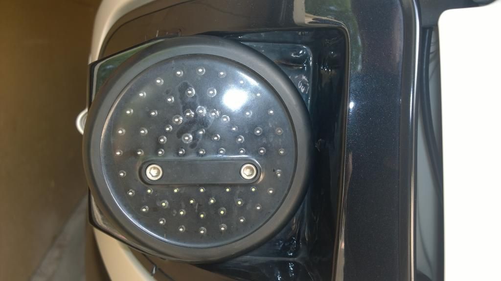

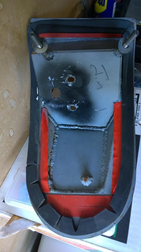

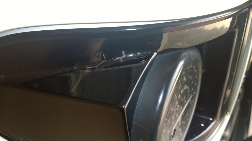

I had been noticing paint failure on the housings for some time. I have never liked that they are glossy black diamond (painted for JimD), so it was time to pull them and refinish.
Notice the paint failure at the inside corners:
More cracking on top edge:

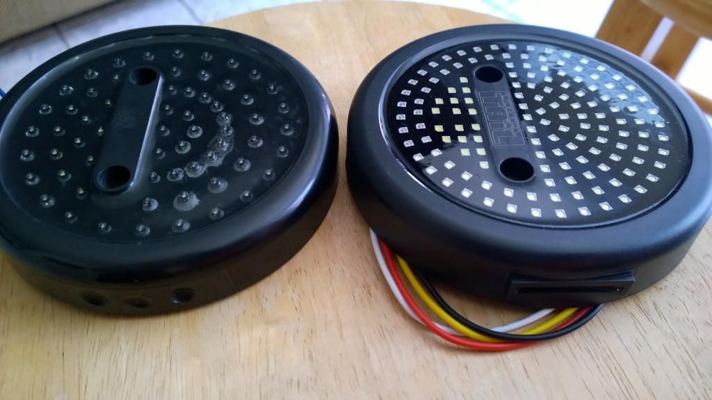

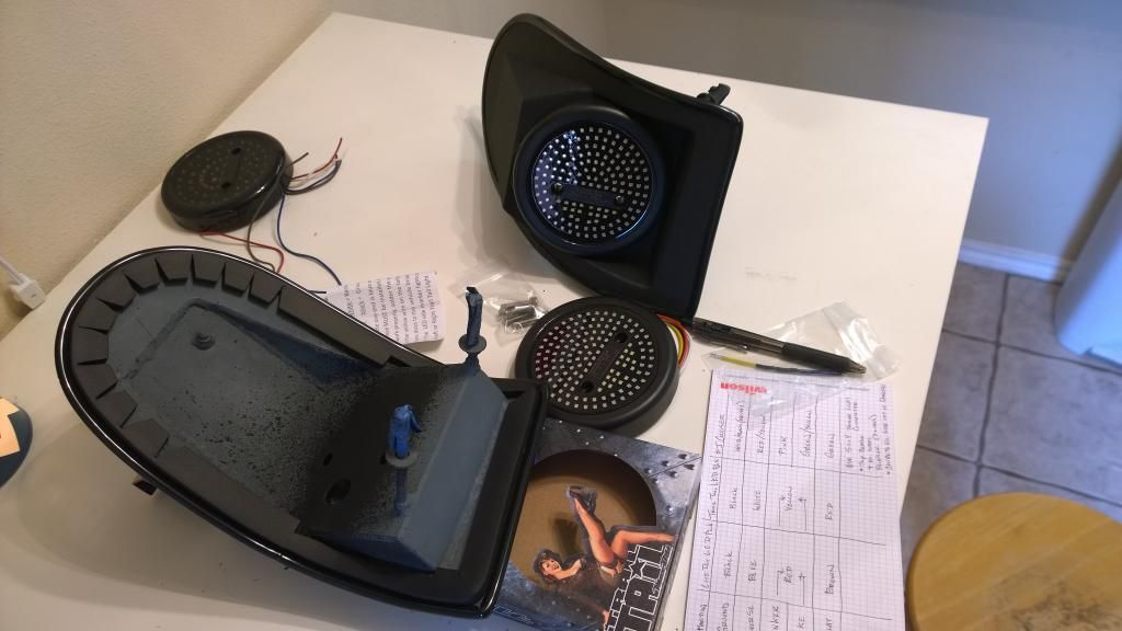

So I did some searching and found a new offering of almost the exact same puck. Max-Bilt Trail Tail LED pucks. So instead of getting a third set of now known very shoddy lights I purchased these. They did cost a bit less than the ones that suck (aka LiteDot.)
I was happy to find the Trail Tails had many more LED lights!
Condition of metal housings and paint. I had at one time thought these were aluminum, but they are just metal... proven by the copious amounts of rust.
The rears were in great shape. Shh... Don't tell JimD.:laugh

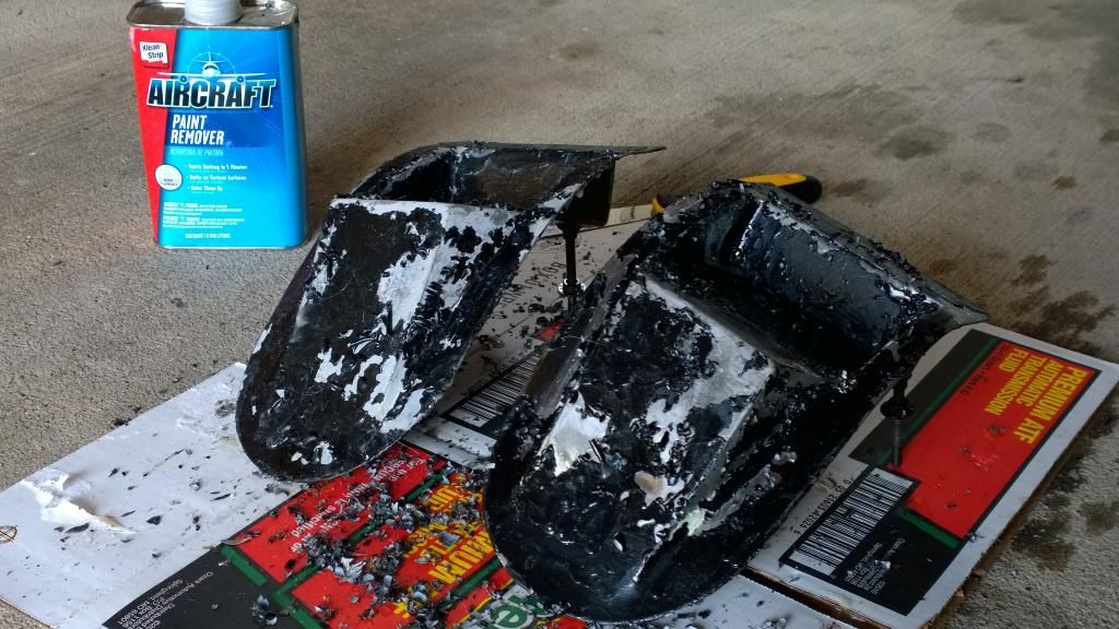

So on to it...

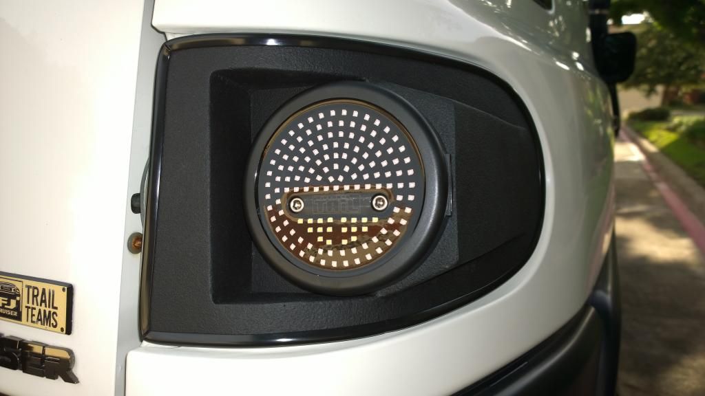

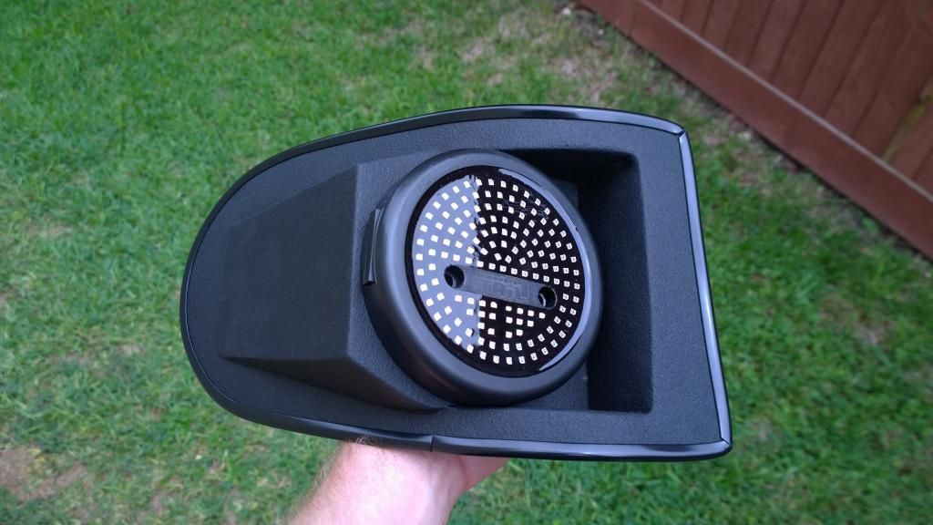

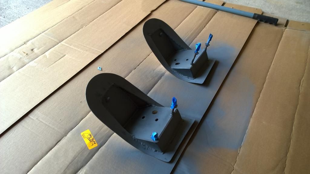

I initially sprayed them a satin black... but could not get the finish and dust conditions perfect to my liking. So I read the forum looking for something... and found some great threads on Duplicolor Bed Armor. I just sanded my day old paint job a bit and sprayed the liner over it in multiple coats. I used the stippling advice with a paintbrush to take care of any splatter drops. Very easy and I like the outcome.
A mock up once I had the trim and gaskets made.

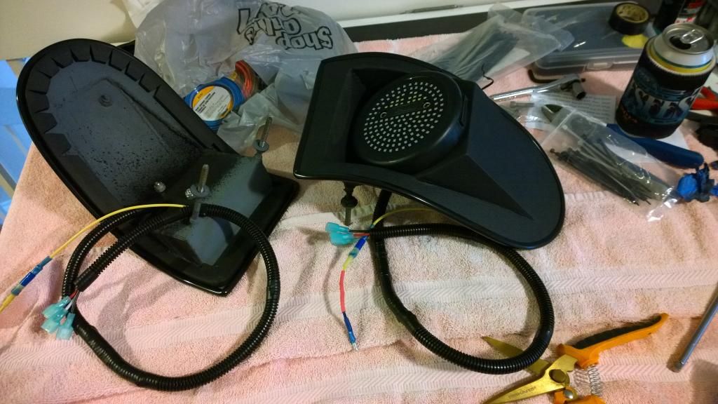

Then I wired up a nice harness on each. Now they plug right in to T-taps. These lights required a diode (per instructions) wired in line on each light to function properly. Without this diode the tail lights would not illuminate when the truck was off. I didn't have these diodes in my other pucks wiring so I did try wiring it both ways... so the diodes are separate in-line plugs which could be easily replaced if needed.
Harness:

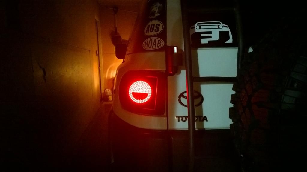

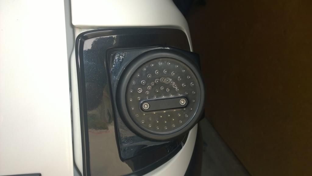

On the truck:

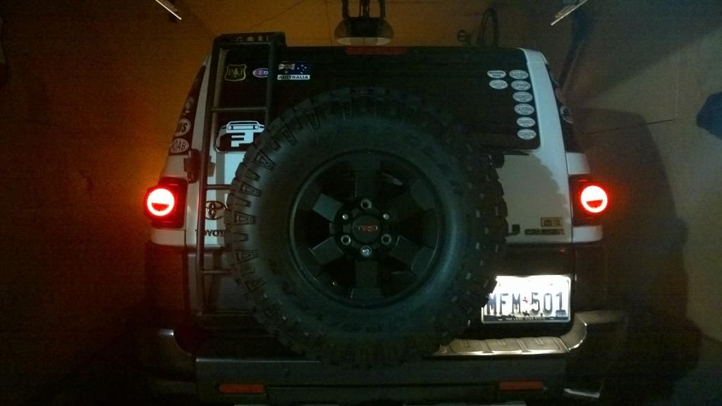

Tail Light:

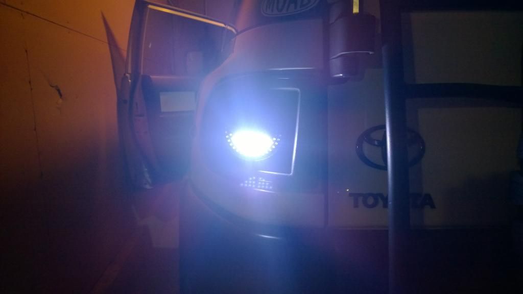

I don't have a shot of the Brake or Turn Signals. The pattern is the same as the Tail Lights, but Bright like the Reverse lights below.

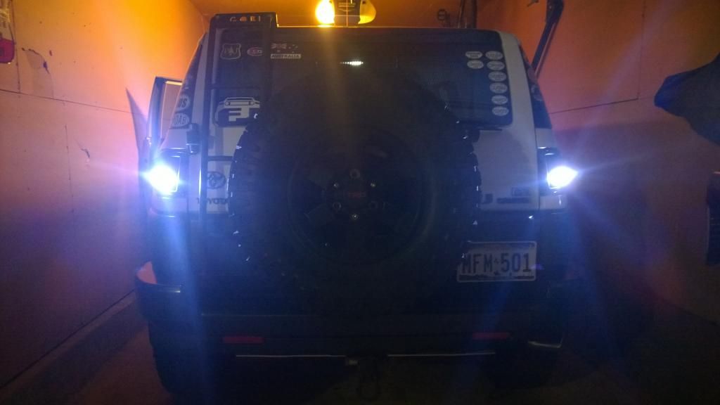

Reverse:
