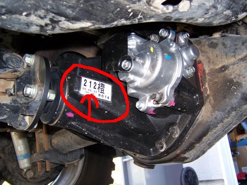

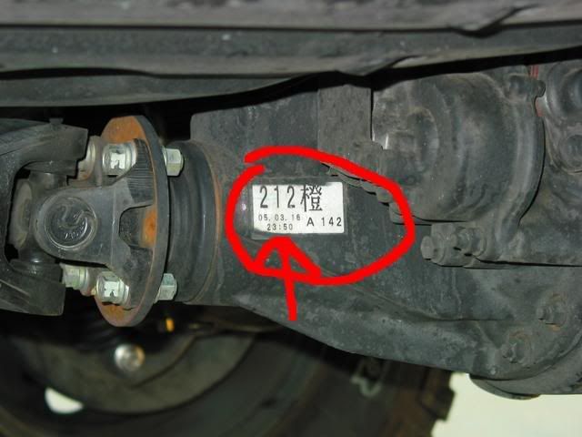

I'm not sure if anyone has started this but I think that we all would benefit and TOYOTA by knowing your build date for all of our members that have had a BROKEN REAR DIFF. Even better please let us know your third member build date
that is stamped on the side of the third member near the E-locker.
this pic shows a org 3rd member buld date of 3/16/05
Here is a pic of a 3rd that was changed out after it blew.. Build date of 2/6/06[/quote]
