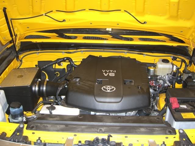

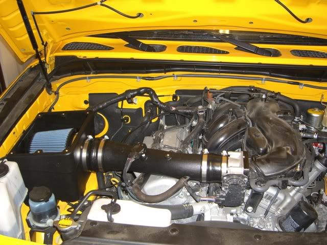

Installed the aFe intake last weekend. Doesn't do much on the low end but once it gets over 2500rpm i notice a nice rumble. I don't hear the sound of sucking in air as much as on other CAIs though. It appears that the mpg went up but will have more accurate numbers a few weeks out.
thinking about the exhaust next. i have either JBA or TRD in mind. Anybody have any recommendations on what goes well with the aFe intake? Did my research on FJforums and TRD seems to be a popular choice but could not find any dyno results. Anyhow, here are some pics of the new intake:

I just put it in a few minutes ago & was wondering about that little red cap that came with mine. It's a cover for a small air scoop on the lower front side of the intake box.
Here's a view of the little rubbery cover that I left off:
Any idea if that's supposed to be on there? I ordered the intake that uses the stock intake off the side of the fender well, but my intake box also came w/ that cover piece and the extra opening.
I'm going to leave it off for now, but I'd like to know if it should be on there long term. I ordered this guy right here:
Toyota FJ Cruiser AFE Magnum Force Stage 2 Cold Air Intake - 2007-2007 Toyota FJ Cruiser - AFE A155481162
if it matters. Yes, I know it is only max 15hp, but I called & they gave me another $20 off :)
Thanks!
~BC
#5 ·
I would put the cap on if your doing water crossings or deep mud, leave it off on the street.
My understanding is that the hole is a carryover from their street CAIs to allow more airflow when the engine demands it. Some folks were commenting that it allows water, mud, etc. to get in and that it also allows warm engine air (partially negating the COLD air intake benefit).
But after reading up a little, I think a starved engine is worse off that an engine that gets a little warm air mixed in with the cold...e.g. sufficient air supply is more important than air temperature.
In fact one of the forum members did a test and put a hinged door on the opening to see if the engine actually needed more air than the stock hole above the wheel well would allow. He set it up so the door would stay at the angle the incoming air forced it to. After doing a test run, he found that the hinged door did indeed open most of the way, meaning the engine did want that extra capacity.
So for normal driving, I leave it open. But if I am going out and water crossings or a lot of mud are possible, I pop it in.
