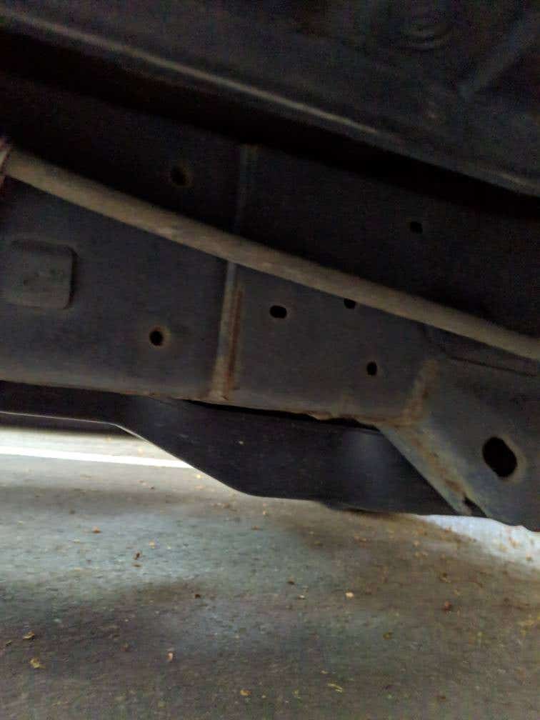

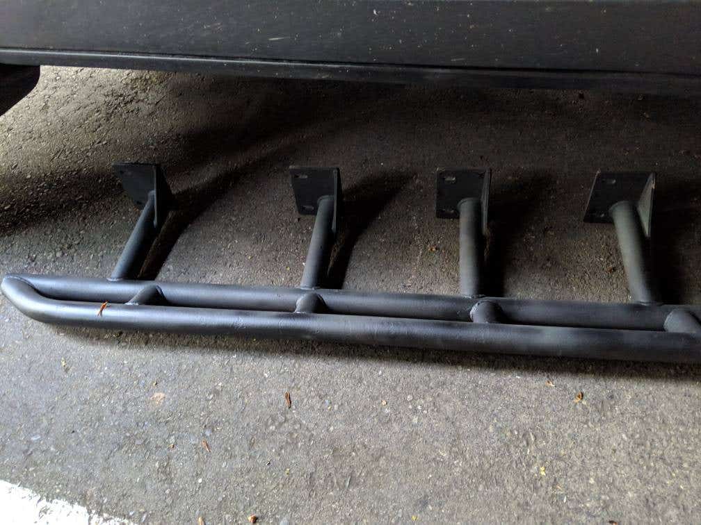

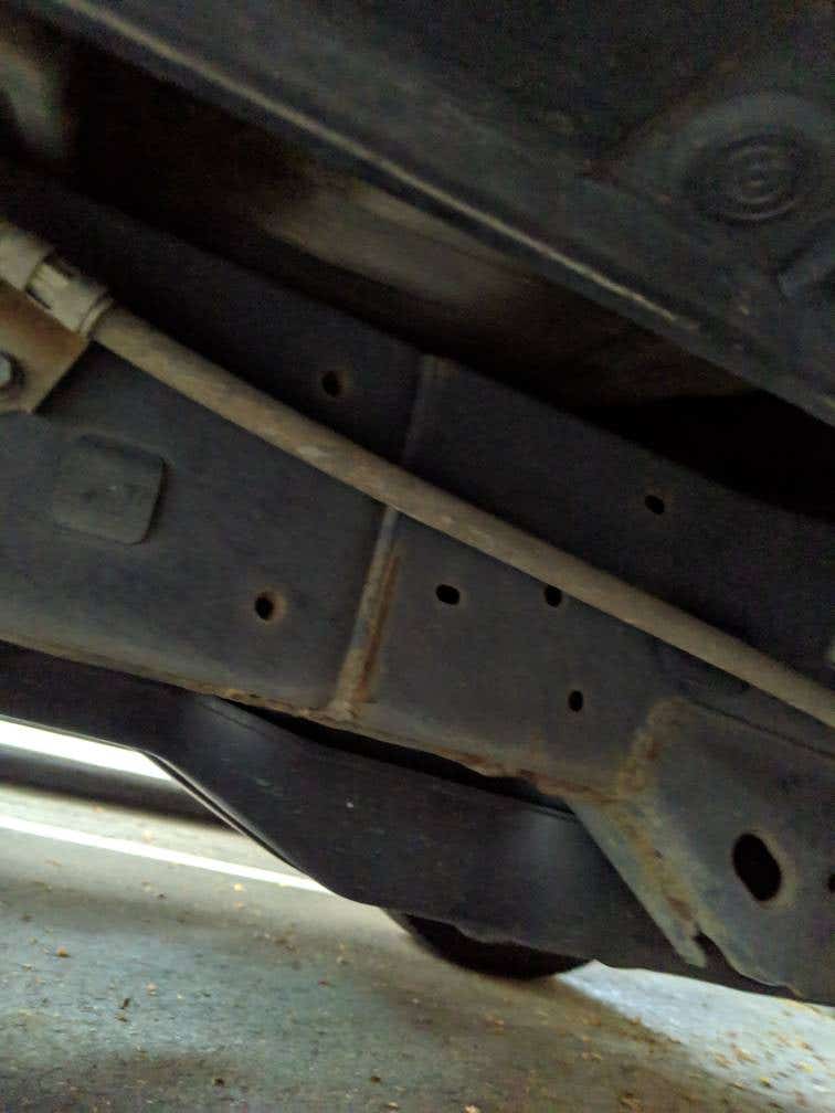

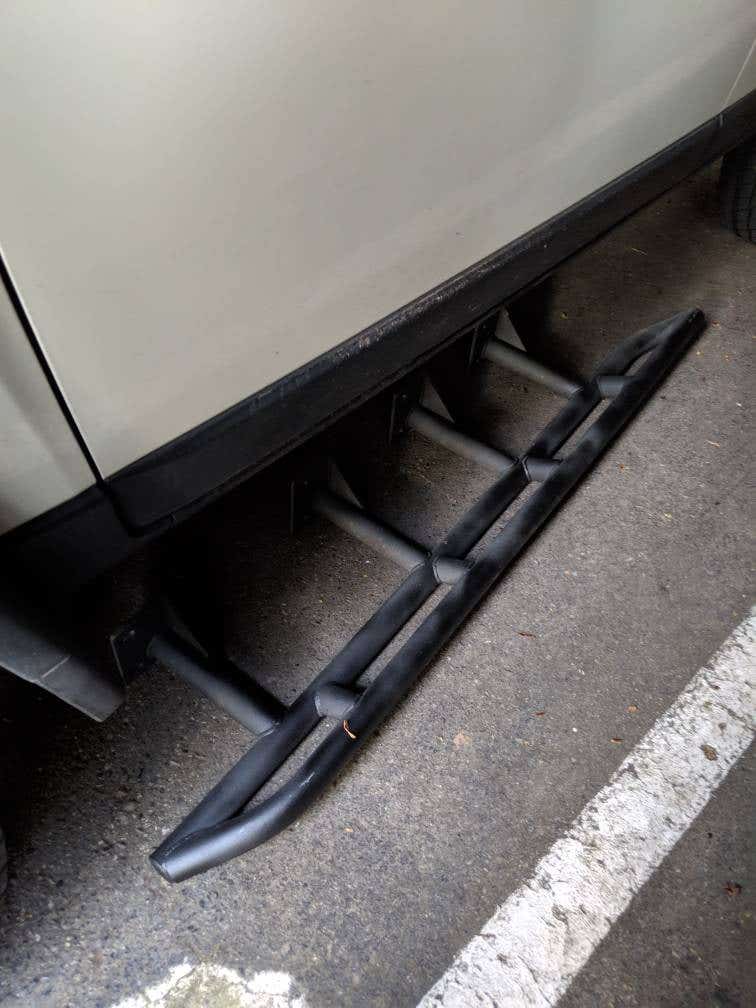

So I picked up these sliders from another local FJ owner and just coated them with the Rustoleum earlier today. I should have looked earlier at the FJ but it looks like there's a cable (brake line? I'm super new to this whole car thing so excuse my ignorance) running where I'd screw in the slider. What can I do? It looks pretty immovable. And if it is the break I'm scared to touch it.
Slightly related question - Im not sure which one is left and right. It's hard to tell from the product photos on the Demello site.
Thanks for the help!

But the brackets start at the front and do not mount over the brake line in the rear. The rear trails behind not being directly attached by a bracket.
Your brackets have a gusset to the plate, which might need to either be removed or relieved on the last bracket to allow the plate to fit up and behind the brake line. Or you might be able to angle the line upward slightly to miss the gusset.
The first photo is the rear and second is the front bracket directly behind wheel opening. When I mounted mine I bedded the bracket plates in water proof grease (green) to help fill any voids and hopefully keep moisture and road salts out.

I don't think you use the mounting holes in your first photo. On mine the front of the slider has a bracket but the rear is cantelevered out w/o a bracket directly underneath. The piece of metal on your bracket I referred to as a gusset in my original post. Worse case you should be able to relocate your cable bracket to another hole in the frame?

Yeah I think I can just move the brake line to a different hole? I've never done this and hope it's fairly straightforward. I'll try tonight
Edit update: those bolts are pretty stuck. I just have a handheld wrench. I think I need to get some penetrating spray stuff.

Yes, sorry. let the chemical spray do its work - overnight. Heat can help but not advisable here since the rubber hose. Can you angle the clip a bit up leaving it in the same hole? That might give you enough to ride the hose/line upward to just miss the gusset on the bracket. If it is still against the gusset, you could pad it w/ some rubber hose split and put over the edge of the bracket secured with some black silicone.
