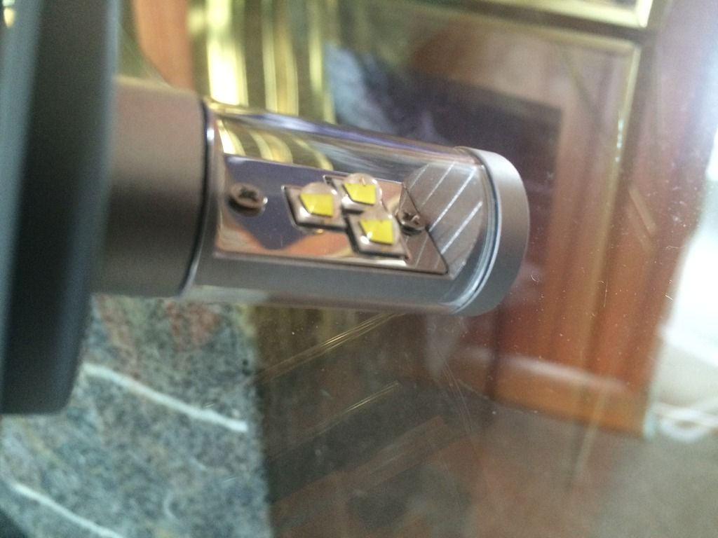

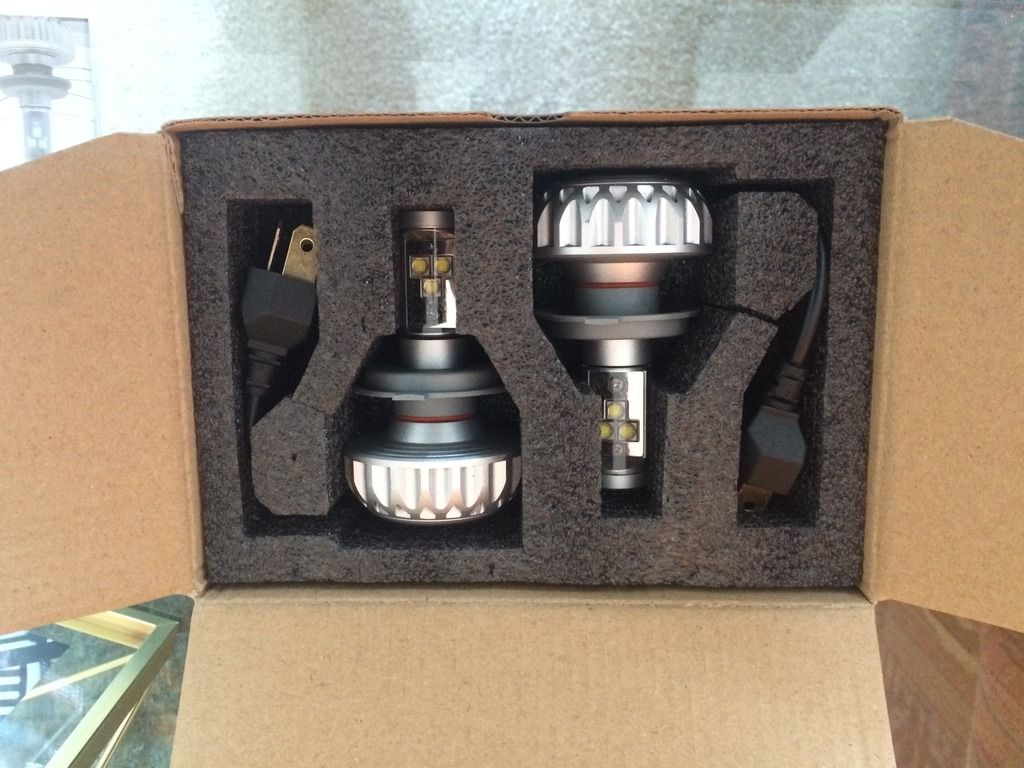

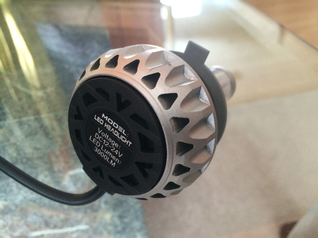

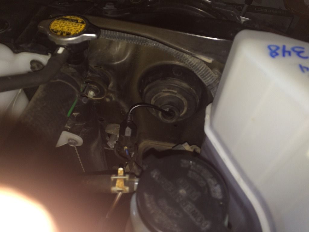

I bought these for $45USD. They don't have fans or control box. I didn't disable DRL, so they're on all the time. DRL mode is exactly low beam mode when the headlights are turned on-no difference at all. No flicker, no modding, so you can keep the rubber dust boot in tact.
I had to re-aim them after installing. The improvement is quite drastic over the 2 halogen bulbs, for only 10 bucks more. Been running them since Dec24, no flicker, no issues at all so far.

I won't buy a Chinese knock-off that has a model name like "LED Headlight". That tells me it's the first and only model of LED headlight they've ever copied.
When Sylvania sells a model the says it fits a 2013 FJ I'll buy it. I've seen FJ headlights on the road that look great, but I don't know what brand they were.

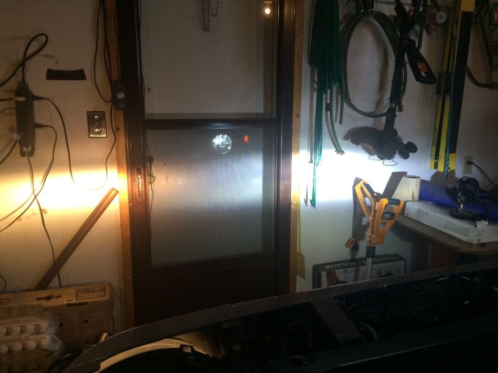

As for light scatter/cut-off of LED vs the halogens they replaced. If you look at the picture that I posted of the 2 lights beaming on my wall in the garage, they project a similar spot on the wall. The LED bulbs I bought have 3 LEDs on the top, and none on the bottom side( so they don't reflect upward blinding people while scattering the light up into the air ). 2 LEDs run in low beam, and 3 for high.
FYI the scatter pattern is light around the focused beam part. In everybody's pictures of different bulbs (not matter the type) there is scatter since this is not a projector type lens/housing.
In your picture the LEDs show a lot of light above the focused beam and this would be perceived as glare for oncoming drivers. Actually also shows it for the halogen bulb, so the OEM housing does not have a cut-off.

Yes, I have to agree with you on what you say above.
