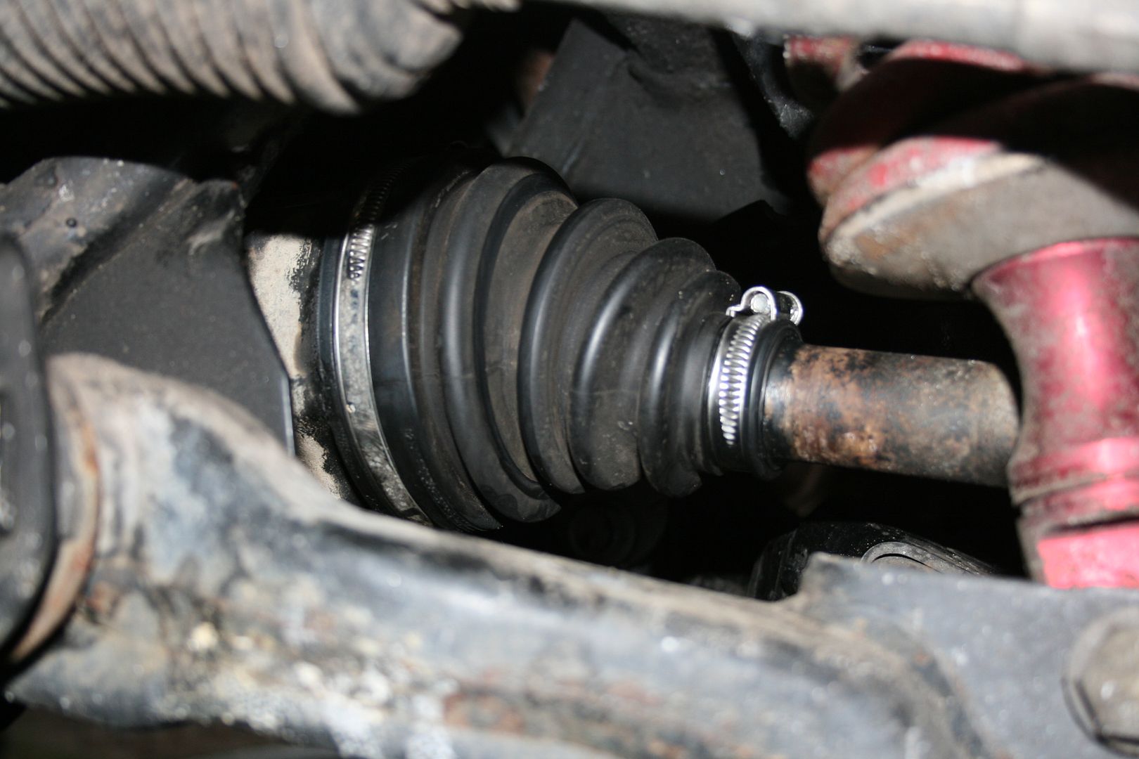

My CV boots' were seeping grease from the boots
due to the OEM bands stretching out from the
increased angle of my CV joints due to the amount
of lift I have dialed in up front on my coil overs...
So, I put my 9mm(3/8") SS hose clamp on the boots
and cleaned up the area using brake clean and paper
towels, and it is holding good, nice and dry... :bigthumb:...

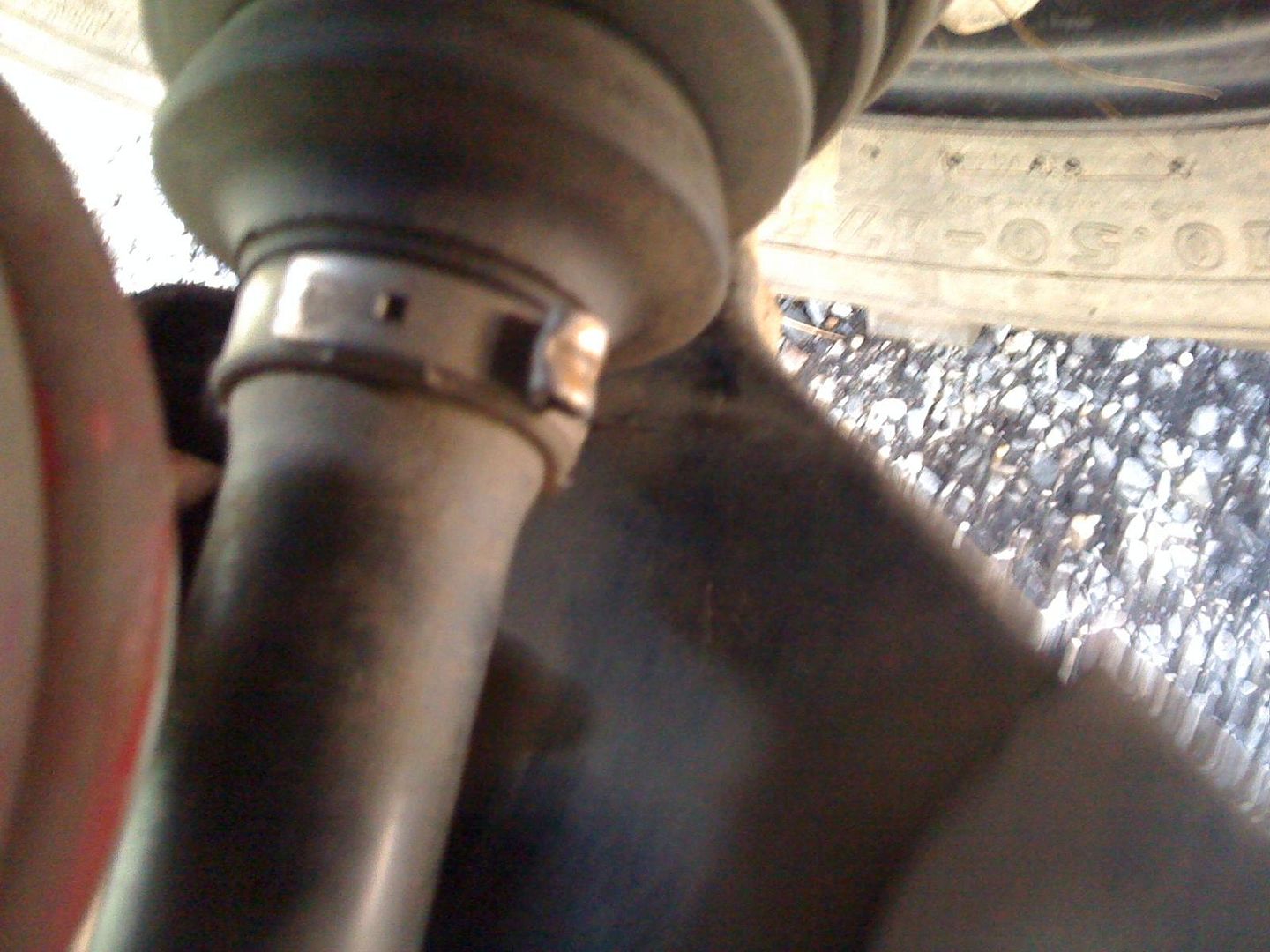

To remove the OEM clamps, I unfolded the two
small side tabs, then lifted the clamp tab to
release the presure... I took a clippers and cut
the clamp off, since they are a closed circle...
EDIT : Added Images...
Here you can see how the 3/8"/9mm clamps fit
perfectly in the boot slots...
Here are a few more picts'...
There are two types of clamps that were/are on my FJ,
one being the folded tab type(shown above), and the
other is a crimp type shown below...
On the crimped type, I simply cut the tab off to release
the pressure and the clamp comes right off...
* ALWAYS BE CAREFUL not to NICK or CUT the BOOT !...

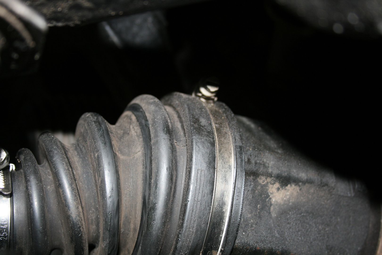

An added note, notice the dark black circle on
this image above, well, this is the rub mark when
I had too much angle on my CV's and the boot
rubbed on itself, the adjoining ring, and started
to wear the rubber away...
IF you are lifted with a adjustable coil over, you
want to make sure you are not lifted above the
point where the CV boot rings rub each other
too much... As you can see below, Mine are good
now that I have re-adjusted my lift...
This can be rectified with the joe dapurak' method... Loosen clamp, slide the boot small end about an inch inward towards the other boot, tighten clamp (must use hose clamp mod).
top axle - boot (right side) in stock position.
bottom axle - boot (right side) moved left towards outer boot on left.
No MORE rubbing, leaking, and less wear on boot ! ! ! :cheers:
