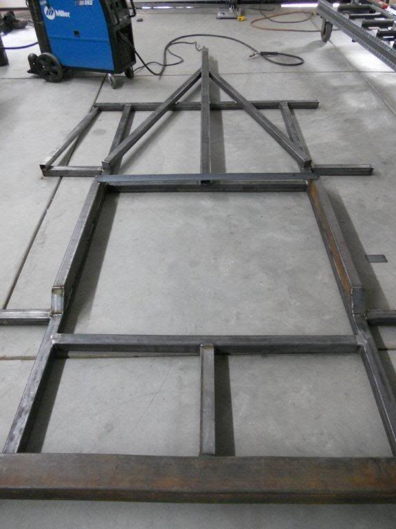

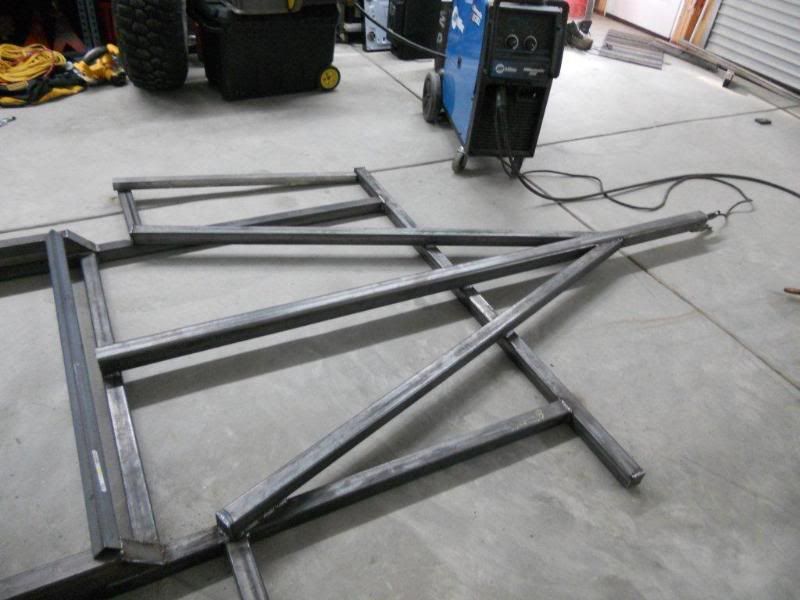

My friend Bob (Skersfan on the forum here) is busy building a new trailer with no time for a trailer build thread. Told him I would start one for him as I know there are many folks that enjoy this type of thing. This is unlike anything else I have seen out there right now, quite ground breaking (pun intended for the trail). When complete it should take almost all trails any FJ pilot dares to go.
Here is the frame for my new trailer. It will be a sleep inside deal. Very aggressive tear drop type, but looks like the space shuttle, fiberglass walls, sleep inside, air conditioning, temperpedic mattress, heat, hot & cold water,stove, fridge, spare tire, generators(2). Hope to have it rolling by Thrill On The Hill

So the base of the frame where the box sits is 51"x99"
The total width including the grid platforms is 80"
From end to end the length is 161"
Yes, it is a solid base camp trailer with over 24" of ground clearence
(more than the FJ)
