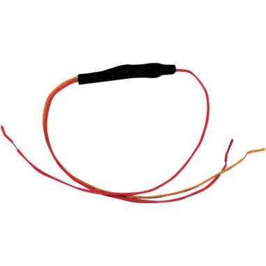

Next I’m going to try figuring out the wiring to reduce the power and hook them up to the blinkers so they’re dimmer when on and brighter as turn signals.
Any luck with, "figuring out the wiring to reduce the power and hook them up to the blinkers so they’re dimmer when on and brighter as turn signals".
I have not found a module like the one used in the original Freedom retrofits conversion kit.
If anyone is looking for brackets, a guy on eBay will sell you them, just message them and ask for just the bracket, they charged me like $20. I used these and the rubber gaskets mentioned in this thread. Anyone have a lead on a resistor to dim the V2’s? Not using them for turn signals, just on with the running lights.
