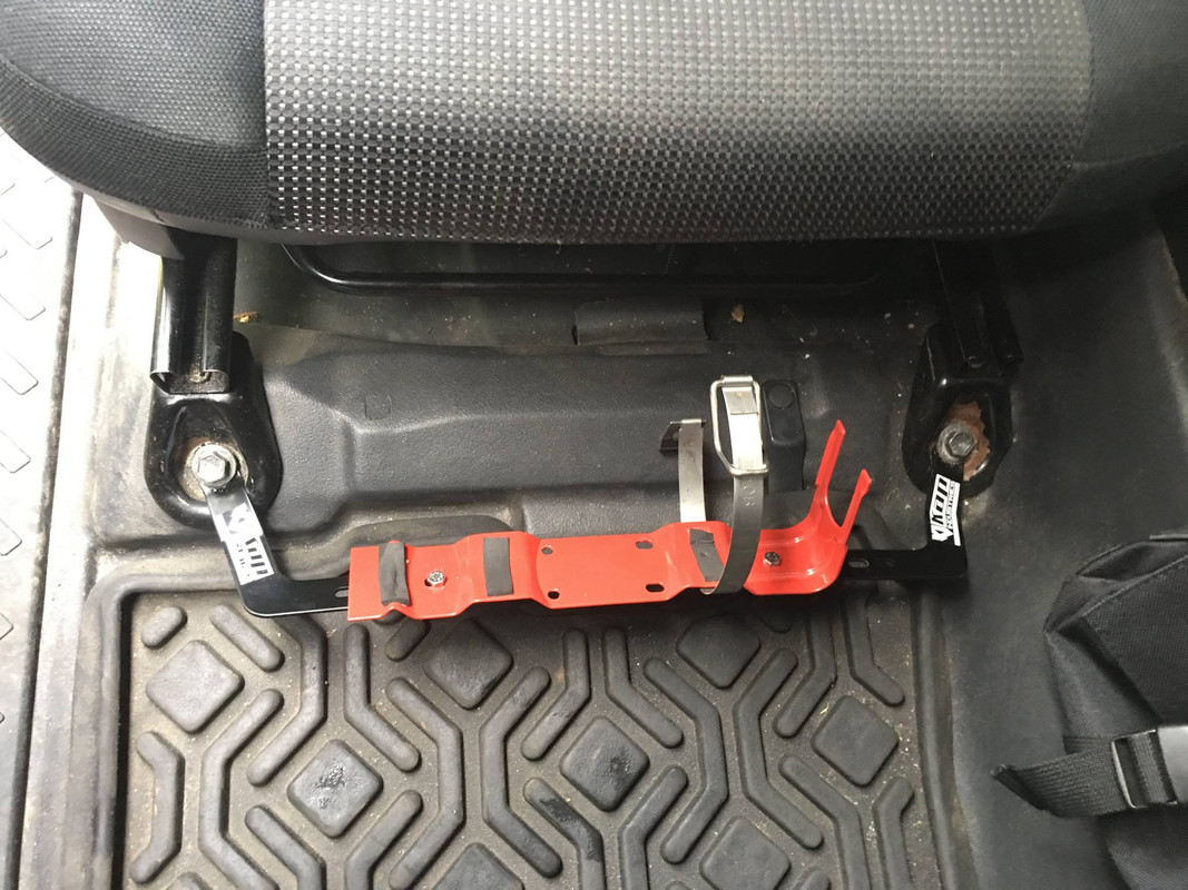

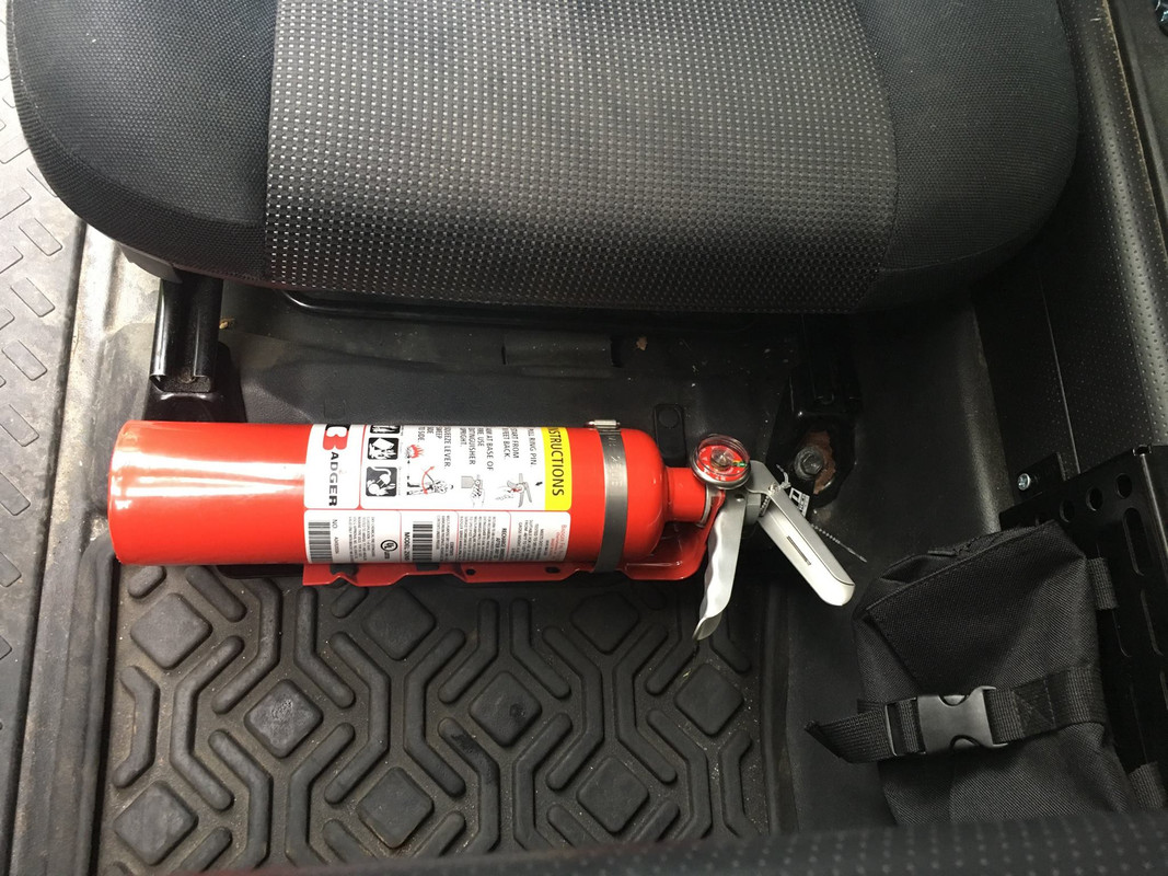

#6 ·
This originally attached to the front passenger seat rail mount, but it was too bulky to keep there. I moved it to the back, which I think is a more common spot anyway. Found it on eBay, made by a guy who makes a ton of stuff for motorcycles. It’s solid.[/QUOTE0]
I like the idea, but I wish there was something more accessible in an emergency.
