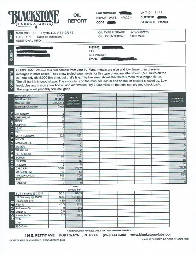

Here are the results from my Oil Analysis. Fj has 60K on it, pulled the oil at 5K interval with Amsoil 0w-20. I changed the oil to 5w-30 on my last oil change and will pull the interval at 7K and post another report in the coming months.
Happy that the 0w-20 has been sufficient weight up to 60K, but feel with the heat in AZ (Summer Months) it may not be the best for long-term wear. I also tow a-lot and and drive it off-road a bunch.
Keep you guys posted
#45 ·
The FJ engine runs pretty cool to begin with. Plus the fan is constantly cooling the engine. I really dont see reasons to go thicker since how good these engines are.
