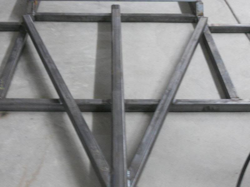

My friend Bob (Skersfan on the forum here) is busy building a new trailer with no time for a trailer build thread. Told him I would start one for him as I know there are many folks that enjoy this type of thing. This is unlike anything else I have seen out there right now, quite ground breaking (pun intended for the trail). When complete it should take almost all trails any FJ pilot dares to go.
Here is the frame for my new trailer. It will be a sleep inside deal. Very aggressive tear drop type, but looks like the space shuttle, fiberglass walls, sleep inside, air conditioning, temperpedic mattress, heat, hot & cold water,stove, fridge, spare tire, generators(2). Hope to have it rolling by Thrill On The Hill

This trailer will set the off road group on its ear I think. Nothing like
it. The only problem is the width, so it will most likely become a base
camp trailer, capable of any road, but to wide for some trails. Still a
slight bit narrower than the FJ, but not as trail worth as my expedition
trailers.
I should have walls done today, they are being bent at All Pro. I am
stopping at Stellar trailers today to look at the fiberglass pannels. If
they are what I want I will order them Thursday with a one week turn around.
The water tanks are under the trailer, and will have access from inside the trailer, under a trap door.
22 gallons of water at axle level will help stability of the trailer for sure.
I am very excited about this trailer.

So the base of the frame where the box sits is 51"x99"
The total width including the grid platforms is 80"
From end to end the length is 161"
Yes, it is a solid base camp trailer with over 24" of ground clearence
(more than the FJ)
